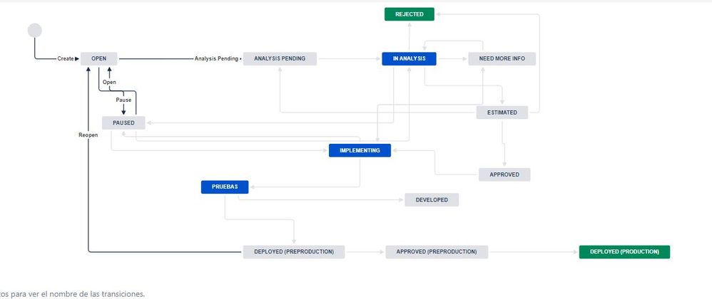

Many thanks @Ankit Srivastava and @Sushant Verma for your answers. The problem is that I've my workflow updated (I'm Admin), but it still don't let me move tasks from "in progress" to "testing" (pruebas). I send you a screenshot of the workflow, do you see any kind of error? Many thanks again!

Hi @Elisabet Griera
Could you please check the below two option:
  1. Are you able to change the state of that ticket from "in Progress" to "Testing" from ticket details view (by opening that ticket)
    ---> If you are unable to change the status then:
    Request you to Navigate to your Project settings > Workflows > Edit > Click in the transition you are try to perform and check if there are any Conditions or Validators that could be blocking it.
  2. Are you unable to change the state of that ticket from "in Progress" to "Testing" from the board only.
    ---> If the issue with the board only then:
    you need to check the board configuration - columns where that columns contains the correct status under it.
