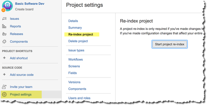

Provided you have the JIRA Adminstrator global permission, you should have been able to simply re-index the project.
Here's a screen shot showing where that option can be found in JIRA Cloud. Do you have it?

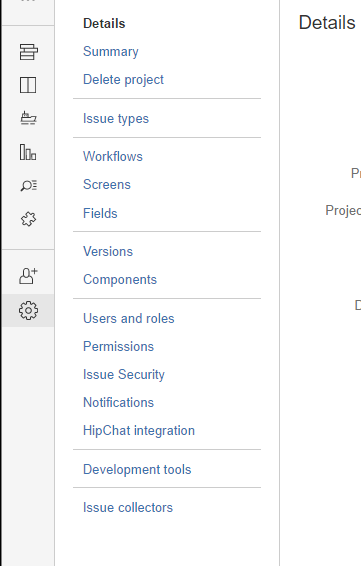

Thanks Sam.
I don`t have this option
