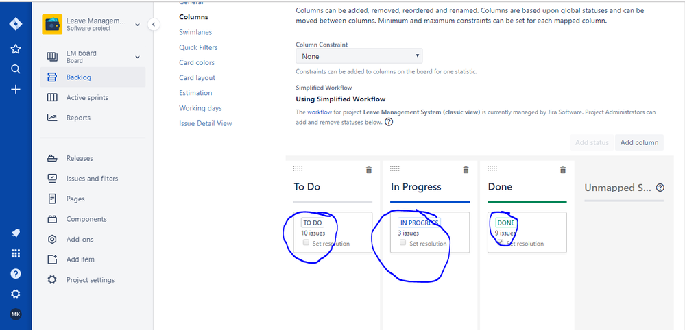

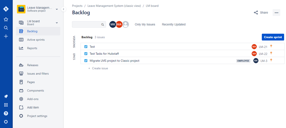

Hi, I am facing the same issue, I migrated from NextGen to Classic project and all tasks are shown in All Issues under Issues & Filters but not visible in backlog. I checked the board setting as suggested I dont have any unmapped issues, But still most of the issues are not visible.
I have 2 Epics and I have assigned the tasks to the epics still i am unable to see them under epics in backlog.

Hi Anddy, not sure if you're still having this issue but I had the same problem and was able to fix it by going to my backlog in the classic project that I transferred issues to, clicking the "..." in the top-right corner and then clicking "Board settings".
Make sure you have the status(es) you migrated your issues to is added to the "TO DO" column. If an issue status is unmapped, it won't appear in any part of your backlog.
This was confusing for me because the board settings screen isn't designed to look the same way as the backlog screen - it looks like you're configuring a board, which apparently the backlog functions as a board on the back end and the page layout was just changed to show sprints instead of status columns.
