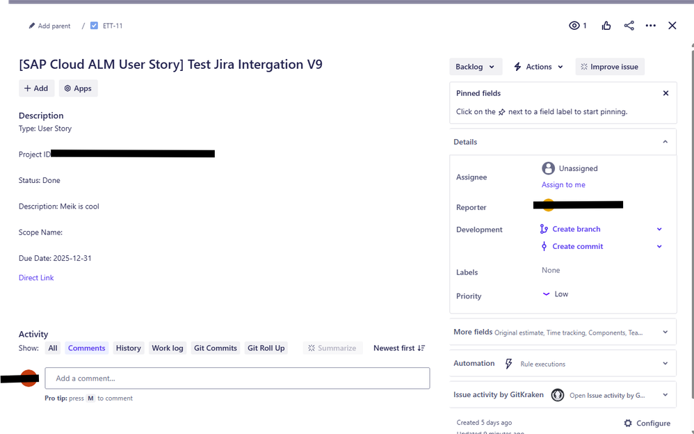

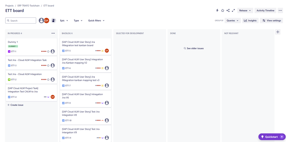

  • My Problem is the status her for the task "[SAP Cloud ALM User Story] Test Jira Intergation V9" is Done and in the Workflow it still on Backlog
  • I want to Task to moved automatically to the right Column in the Kanban Board Depending on the Status, any Idea how can i automate this in Jira?

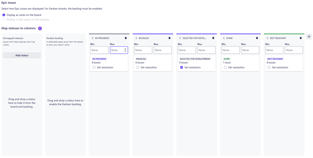

Based on assumptions here, it seems you might have BACKLOG status mapped to DONE column of the board, you may need to check the board config here to know 'which-status-mapped-to-what-columns'.

If still an issue: Share the board column config and workflow snapshot.

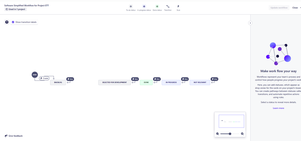

  • Thanks for the quick reply, i really appreciate it. Anaway i'm not sure regarding to the instruction what should i do exactly right now, since i'm pretty new to Jira. I would like as you required to share the Kanban Board and the Workflow with you, i'm glad for your answer and suggestion what to do here :)
  • Picture Workflow

Thanks for the screenshot. Based on screenshot, no issues observed, but a correct as 'set as resolution' would be for the Done column, not for the selected for development.
Can you check again moving ETT-11 to backlog and moving done again  and check in the board, if you issue is still in backlog, there could be data issue in the application.
I the ETT-11 view, you can see the drop-down for the status selected on right column top.
quteiba.alsalaa
April 28, 2025
Yes, i did, but nothing changed, any other suggestion?
