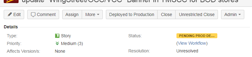

Here's a normal story in the same status as the broken one:

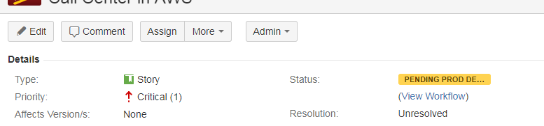

Here's the broken one:
Nic Brough -Adaptavist-
February 12, 2018
Only thing left is to move it to a different workflow (change the issue type, or move it to another project) and back again
Esther Strom
February 12, 2018
Tried both of those (moved to a different issue type in the same project, moved to the same issue type in a different project with a different workflow.) Neither worked. I've opened a ticket with Atlassian support. Thanks for all the suggestions.
