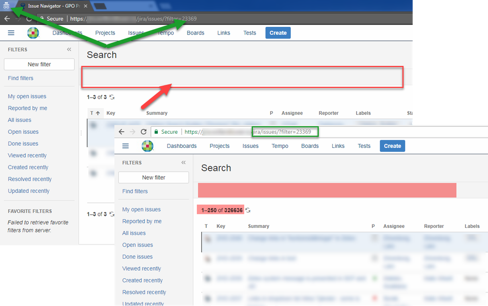

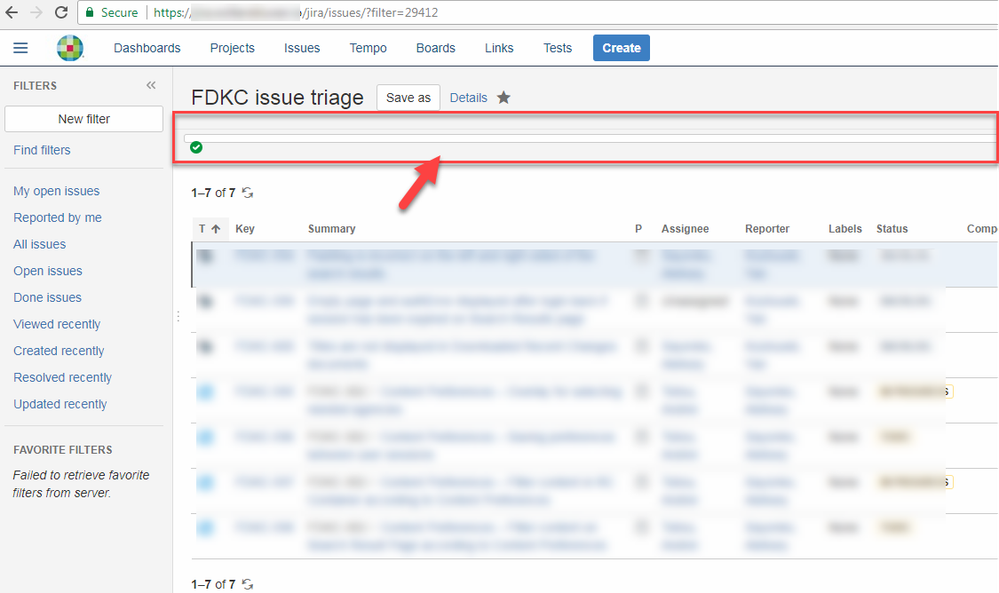

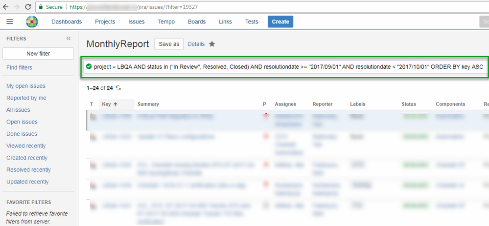

hi, I'm experienced with an issue where in most cases MISSING QUERY bar
I wonder if this bug is reported anywhere?
JIRA Server V7.4.3
Please check attached screenshots

I took a deeper look into this problem and I think that there is an existing bug that directly relates to this problem.  Although the title is slightly different, it does appear to have the same documented side effects.  Please see https://jira.atlassian.com/browse/JRASERVER-59185
It looks like this can happen when one of more of your shared filters in Jira has been shared with a group, and that group has been subsequently deleted from Jira.
This can be tricky to troubleshoot because there could be lots of filters in Jira that being affected by this.  In order to try to narrow down which specific filters have this problem, I recommend trying to run the following SQL query on the Jira database:
select sr.filtername, sp.* from sharepermissions sp join searchrequest sr on sp.entityid = sr.id where entitytype = 'SearchRequest' and sharetype = 'group' and param1 not in (select group_name from cwd_group);
This should at least return to us a listing of the filters in Jira that are currently shared with a deleted group.   From there you should then be able to edit those filters in Jira in order to update the shares and remove the deleted group.  That should then prevent this problem.
