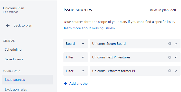

I can't find some Stories in Advanced Roadmaps (AR) that are listed in the Backlog of the Board I am displaying in AR. I already checked Exclusion Rules (I set up "...completed Issues after" 999 days), I compared the Stories and they belong to the same Epic, same Team, same Sprint, same Component, same Statuses).
Any Ideas? Thank you in advance

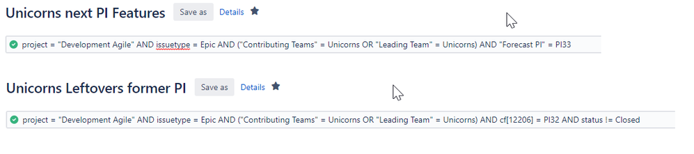

1) As Issue Sources I use a Scrum Board (to have access to all Stories), and additionally two filters (to have access to the corresponding Features that contain the Stories.
2) Yes, The Board have a sub-filter applied (especially to filter per Team and Component)
3) I am testing the Plan and apply and disapply filters as I need.
4) I am sending you some images that may help

This is our Filter in the Unicorns Board:
project in ("Development Agile") AND Type != Epic AND component in (BPMS, SWIP, Camunda) AND "Leading Team" = Unicorns ORDER BY Rank ASC
We don't have sub-filters in the Board, only in the Advanced Roadmap source config (the ones I sent you before).

The board filter itself is very specific. Breaking it down:
  • a single project (no risk)
  • Tyne is not an Epic (no risk)
  • Components; BPMS, SWIP, Camunda, have to be against an issue type. (there is a risk that this could cause some Stories being missed that could be linked to Epics)
  • Leading Team field (I assume this is a custom field?), has to be Unicorns (There is a risk a Story is not assigned this value.
So a Story has meet all 4 points of criteria to be listed on your board. How many stories are currently on your board?
On a separate note, the issue filters are very specific, i.e. Leading Team needs the Unicorn value, and the custom fields need a certain value aswell.
