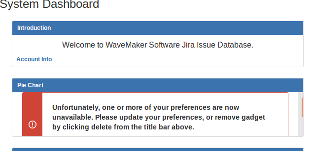

I have upgraded from Jira6.4.2 to Jira7.0 as per the mentioned steps, Everything looks good except the below issue, On the Login page of JIRA dashboard, below message is seen in Pie-charts section
Unfortunately, one or more of your preferences are now unavailable. Please update your preferences, or remove gadget by clicking delete from the title bar above.
I have seen the Jira logs, but no clue over it why it is coming.

Changes were made to Jira between the versions in order to change how users are granted access to Jira and who can see issue data in Jira.   There is a bug for this behavior in https://jira.atlassian.com/browse/JRASERVER-45227
Basically I suspect that your account does not currently have access to see the filter that gadget is using.   That would explain this error message.   I would recommend editing the gadget to see the filter name in use there.  Then see if your account can view that filter in the issue navigator.
I would recommend having the owner of that filter make sure that the filter is actually shared with your account, group, role in Jira.  I think that should help avoid that error.

Thanks Andrew, It was for Anonymous login.

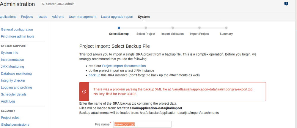

In my current jira cloud account there are 3 projects, i want to import one project from jira cloud to jira server , as in Jira server there is option to import specific project as per the below documentation.
https://confluence.atlassian.com/adminjiraserver071/restoring-a-project-from-backup-802592982.html
When i was trying to import the project getting the below exception in the log and also the attached screenshot.
2018-05-28 12:47:49,364 JiraTaskExectionThread-2 ERROR saikrishna 767x949x1 jwxqvq 14.141.6.170 /secure/admin/ProjectImportSelectBackup.jspa [c.a.j.imports.project.DefaultProjectImportService] There was a problem with the SAX parsing of the file '/var/atlassian/application-data/jira/import/jira-export.zip' when performing a project import.
org.xml.sax.SAXException: No 'key' field for Issue 33102.
com.atlassian.jira.exception.ParseException: No 'key' field for Issue 33102.

Andy Heinzer
May 29, 2018
You can't use the project import in Jira Server in order to import projects from a Jira Cloud backup.  I can understand the confusion over this point, it's actually a very common misunderstanding I have seen a number of times in support cases.
You first have to restore the entire Jira Cloud backup to a new Jira Server site, using the setup wizard to 'import existing data' during the setup phase of that new Jira site.   I would recommend that you closely follow this guide: Migrating from Jira Cloud to Server applications to be able to complete the migration of that data successfully first.   Only once that restore is complete can you generate a new Jira Server XML backup of your data from that site and use that for the sake of doing project imports.
There is also an expectation that when you migrating from Cloud to Server, that Jira Server be at the latest available version.  As of today, that is 7.10.0.
When doing project restorations, there is also an expectation, that the source Jira site where the backup is created from will be on the same version as the destination Jira site.  As such, I would recommend that you restore the cloud backup to a fresh Jira 7.10.0 installation, and also upgrade your existing Jira to the same version.   That way when you go to do the project imports your chances of encountering unexpected problems should be much lower.
