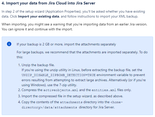

If you're importing the entire site into an empty Data Center (no projects), it's a simple matter as outlined in this note: https://confluence.atlassian.com/adminjiraserver/migrating-from-jira-cloud-to-server-applications-938846963.html
If you're importing the site into an already-populated Jira Data Center instance, you need to have an intermediate blank instance that's the same version as your existing instance.  You then do a Cloud -> DC migration and then DC -> DC migration.  This link may help. https://confluence.atlassian.com/adminjiraserver/restoring-a-project-from-backup-938847691.html

I am trying to do this as well (import a cloud backup into a DC instance). I've already ran the DC installer and am logged into that Jira instance (completely blank DC instance). Do I have to uninstall and re-install to get back to the wizard to perform the import (as step #4 indicates in the linked article (See screenshot below))? Or is there a way from the System -> Import and Export section?
