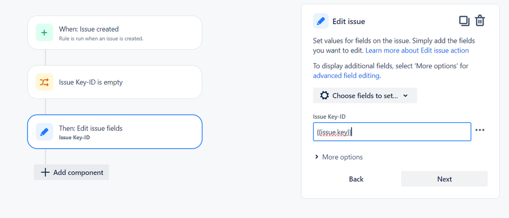

Cédric Daemen
December 20, 2023
Hello Arthur
if there are no tickets created in the new project, there shouldn't be any problems, but from what I understand this isn't the case.
So here's an alternative solution:
I created a custom field beforehand
In the team managed project:

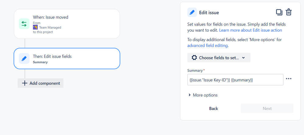

in the company managed project :
I hope this might helps you, otherwise let me know,
