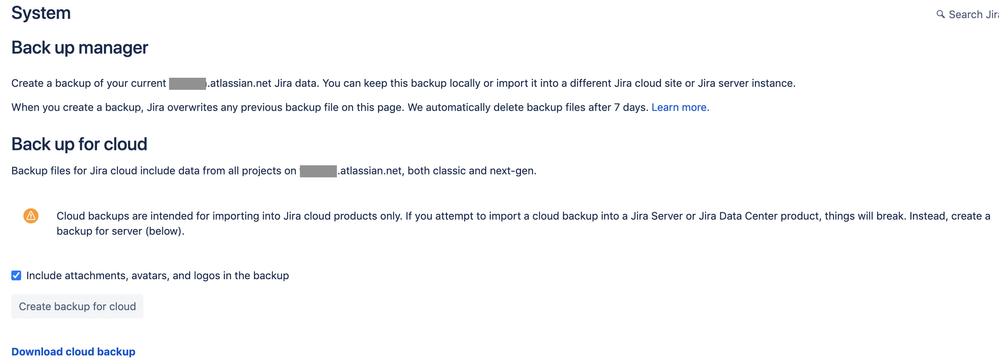

I'm not sure about the JCMA because "The Jira Cloud Migration Assistant beta (JCMA) is here to help you migrate from server to cloud", So Is it possible to migrate from Cloud to Cloud?
But in the case of simple step, The process to take my source is the "Back up manager" function, Can I?
If yes, How backup a single project because It seems all projects were backup.
Anyway, Is there any helpful jira add-on?
please kindly let me know

You can only export a single project into CSV, and only 1000 issues at a time. To do this, search for issues in your project and export search results into a CSV. This won't give you the attachments. This is why I am suggesting a full export and import into a self-hosted instance as a more robust approach.

I think that full export and import is meet my requirement but there is no test server,
As my above comment:  It seems that full export function is can't specify only a single project. Can I know the next action if I need export/import only a single project?

You can do single project only by using JCMA on a temporary self-hosted (server/datacenter) instance. The only way to export a single project from a cloud instance is via CSV/REST API.
