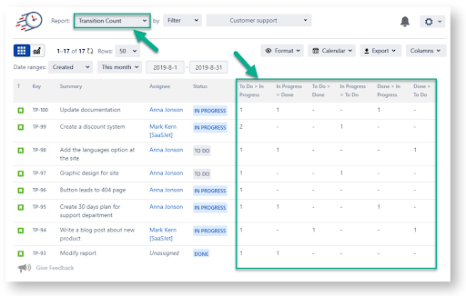

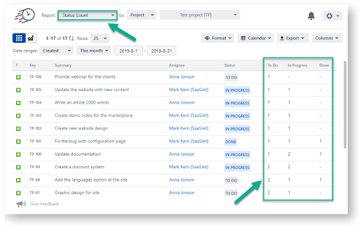

If you want to identify how often an issue has been in a certain status, I suggest trying the Time in Status for Jira Cloud add-on developed by my SaaSJet team.
Here are examples of two types of reports you can try:
Status count
Transition count

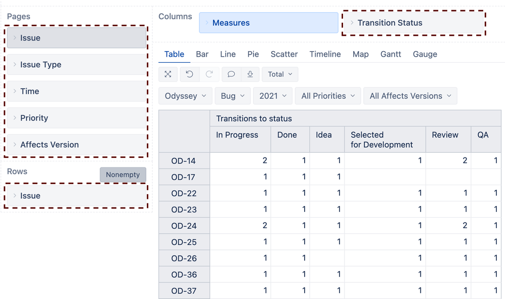

Others have already suggested good options. Another app you can consider is eazyBI - https://marketplace.atlassian.com/apps/1211051.
Delivering reports on Issue history and status transitions is just one of the aspects of its functionality. For example, the first iteration of a report with your requirements could look similar to the one below:
You can filter the report results by other aspects, for example Priority, Affect version, time period of the transitions, etc.

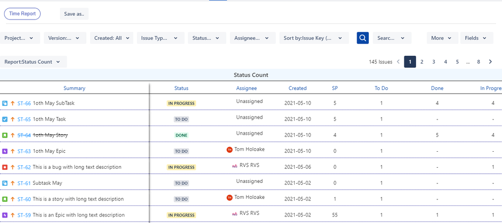

If you are ok with a marketplace app to get this data (count in each status) you can try out our app.
Time in Status Reports
The add-on provides the time in each status for the entire lifecycle of the issue and you can filter by issue type as well. You can also combine your statuses to define your lead/cycle/resolution time and also extract the transitions history of the issues. The main features of the app are as below
Also there is a report for the dates when issue transitioned from one status to another.
