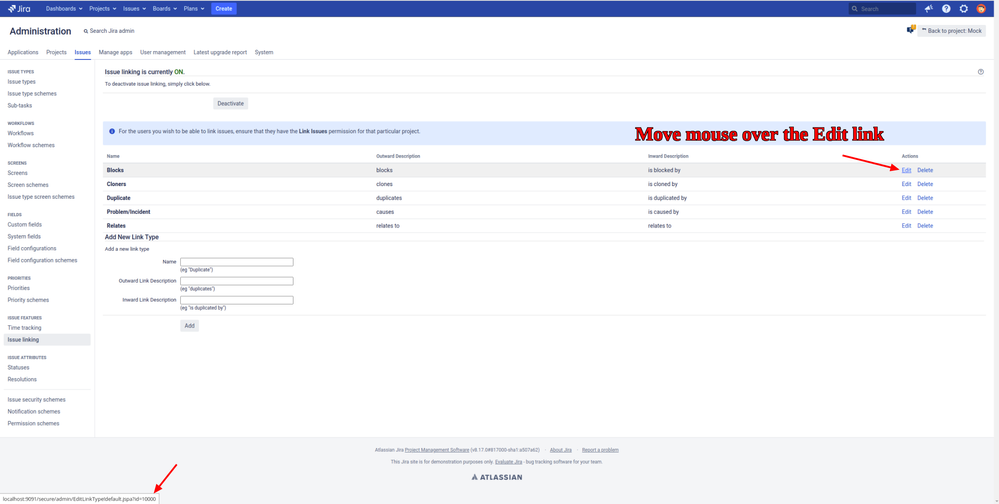

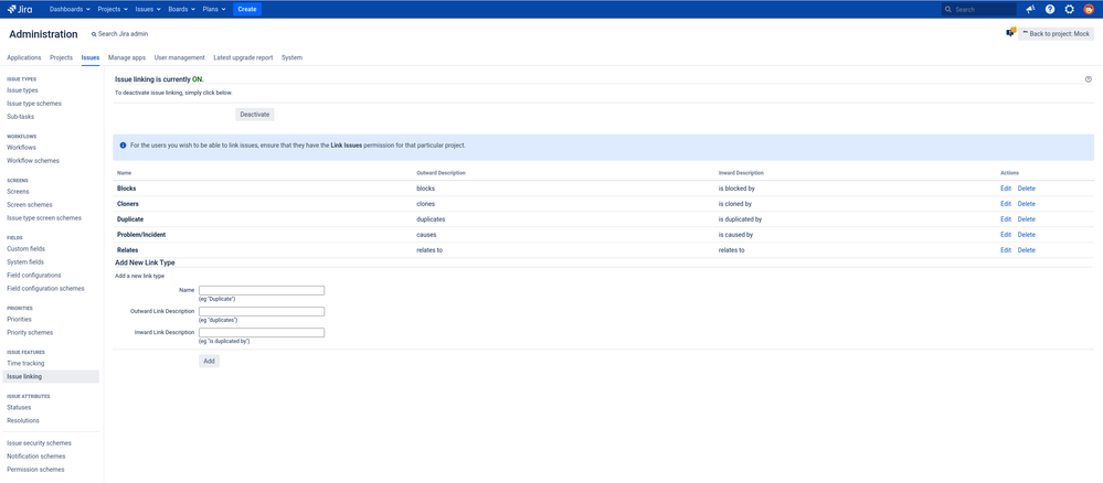

You will also need to refer to the Issue Linking page as shown below issue_linking.png
and move your mouse over the Edit link to get the correct link id to be used as shown in the image below:-
I hope this helps to answer your question. :)
