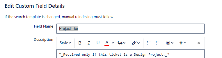

I've added the following markup to my custom field description:  (Sorry I could get neither code block nor quote to work)
*_Required_*
As outlined in process document: T-23
The following tier descriptions were valid as of July, 2024. Consult the current process document for up to date tier descriptions.
*Tier 0*
* It's easy.
*Tier 1*
* Short projects
*Tier 2*
* Medium projects
*Tier 3*
* Large projects
*Tier 4*
* Mega Projects
This detailed description was added after the field was created.  I can't seem to get the updated description to show.
What am I missing?

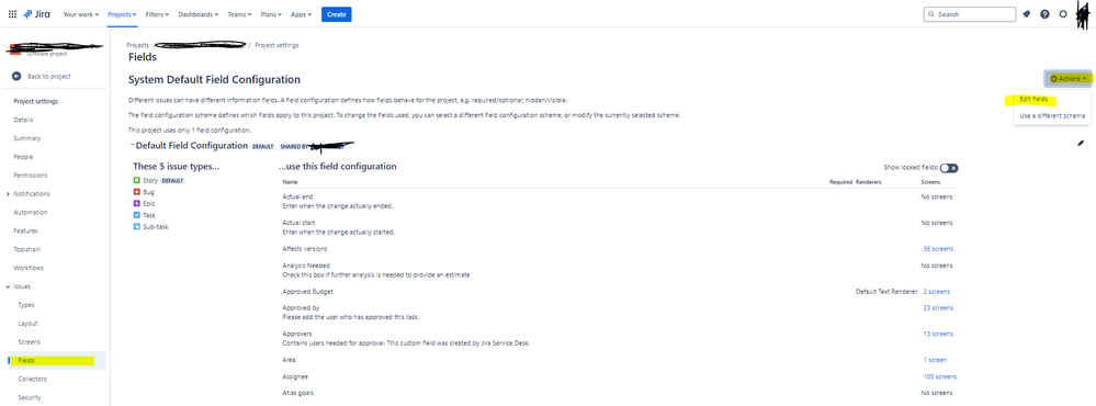

Hi Christa - Welcome to the Atlassian Community!
There was a bug at one time that was keeping the changes from showing.
Go to the Field Configuration for that Project and update the field description there and you should see it.

Christa Meck
August 2, 2024
Hi there @Dexter de Vera
This is for a CUSTOM field description not the CUSTOMer field.
  • Jira Software.
  • Company Managed.

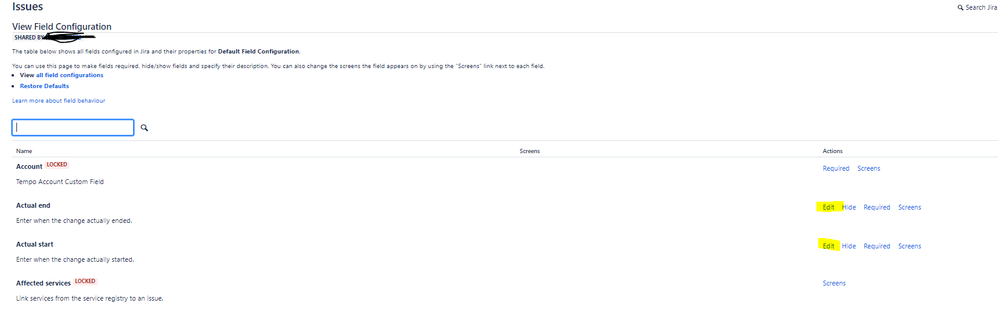

If not, you can update the description in field configuration of the project.
By going to project settings - Fields - Action - Edit fields
Then look for the field then edit it.
Hope it helps!
