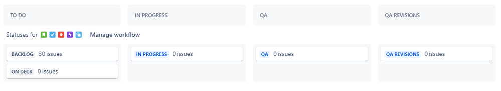

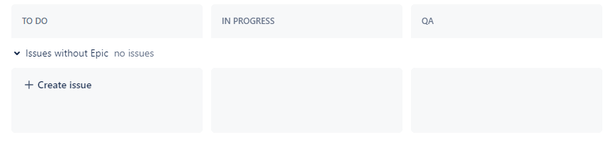

While configuring a board in a Team Managed Project, the board does not display issues with mapped statuses as expected. There are no filters, and I've cleared my browser cache. All statuses are mapped in the board configuration but issues with the corresponding status do not display on the board. Any suggestions or workarounds?
I've reviewed other threads with this issue, but I'm not finding a solution:
https://community.atlassian.com/t5/Jira-Software-questions/JIRA-Version-Display-not-mapping-issue-status-correctly/qaq-p/836195
Board Config View:
Board User View:

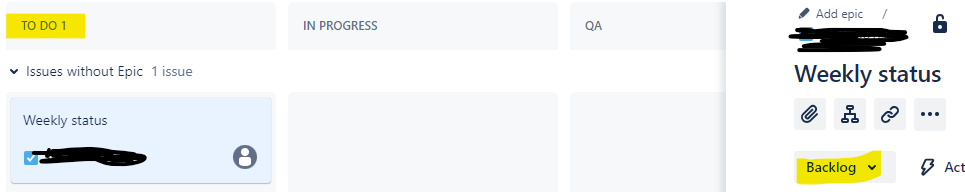

BOARD1.pngOddly enough, if I create a new issue FROM the board, with a backlog status it displays as expected. However issues NOT created from the board do not display.

If you are using a Scrum board then when you create an issue using the Create button in the menu bar, the issue will go to the Backlog. It will not automatically be added to an active sprint on the board.
If you are using a Kanban board and have enabled the Backlog screen then in that case also using the Create button from the menu bar will put the issue into the Backlog, not the board. From the Backlog screen you have to move the issue from the Backlog list section to the Board list section above it. Using the Create option within the board column will automatically add the issue to the board.
That is different behavior than what you would see with a Kanban board in a Company Managed project. In a CM project that has a Kanban board and Backlog screen, positioning the issue in the Backlog list or on the Board is based on the issue status. That is not the case with a Team Managed project. An issue can be in any status and be in either the Backlog list or on the Board.

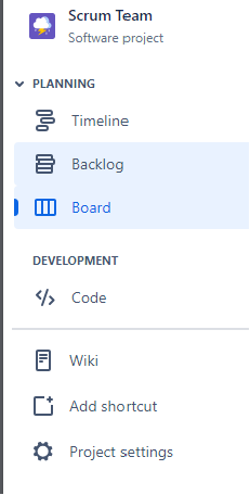

Do you have any tickets in "Backlog" ?
Christina Williams
November 21, 2023
Yes, I can view them in backlog but not on the board view

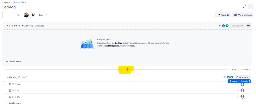

Ok, you might need to drag / drop them into the backlog in a way to see them, then start the sprint
Christina Williams
November 21, 2023
Thank you! That's what Trudy suggested as well and I got it to work :)
