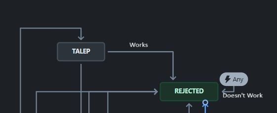

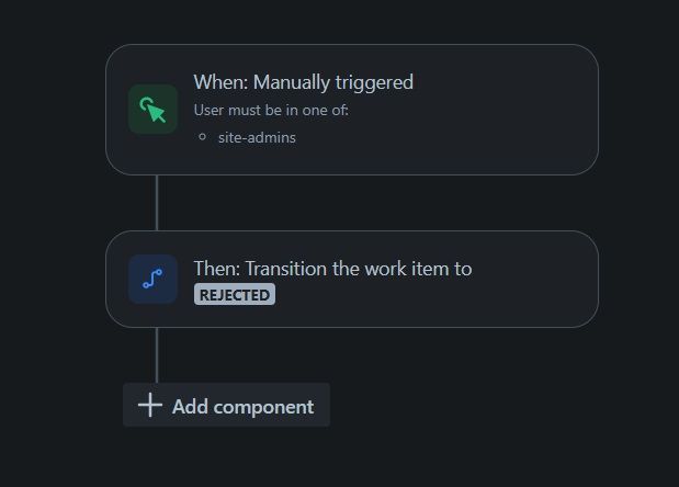

I would like to create a manually triggered automation, to transition an issue to rejected or done status. I am creating a issue transition to desired status from all statusses. But automation does not work this way, it only works if a direct transition exists.
Is there a solution for this error. I am a site admin so there should not be a permission issue.

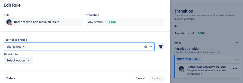

Is there a specific reason why you want to trigger an automation rule instead of configuring the workflow itself? You could restrict the transition to Rejected/Done to only site-admins:

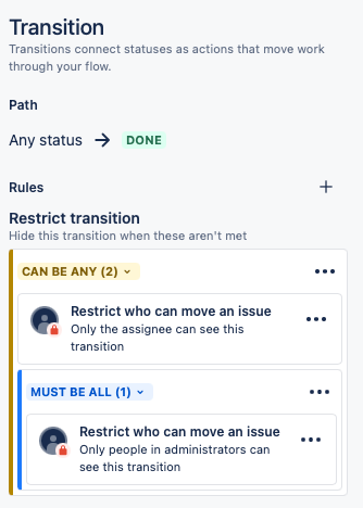

If you want both the assignee and the sales team group to be able to transition the issue, you’ll need to adjust the rule settings to "can be any". See example below:
  • The assignee can see and perform this transition
  • OR people in the administrators group can see and perform this transition
You'd just need to select the "sales team" group instead of "administrators".

yes but the problem is issue transitions are only permitted to assignees so this solution doesnt work. Because they would like to close the issue whenever they want. That's why i tried to create a rule that only they would see and execute this rule from any status when they are not the assignee. and by this rule they could transition issue to done or rejected status. Workflow is too crowded to create a transition from all of the status, so i used the "any" transition on first pic.

As you stated, Automation cannot do something that a regular user also cannot do (in most cases). So, if a transition does not exist, then Automation cannot make the ticket go to 'REJECTED' straight away.
You've mentioned in the first picture that the 'Any' transition 'doesn't work'. Can you clarify? You can set limitations in that transition in the workflow editor by defining who is allowed to make that transition.

Hi thank you for your response, I explained to Manon why I need this. You know you can give a transition to a status from "Any" statuses. I already did that so there is a transtition. but it is not accepted as a transition.
