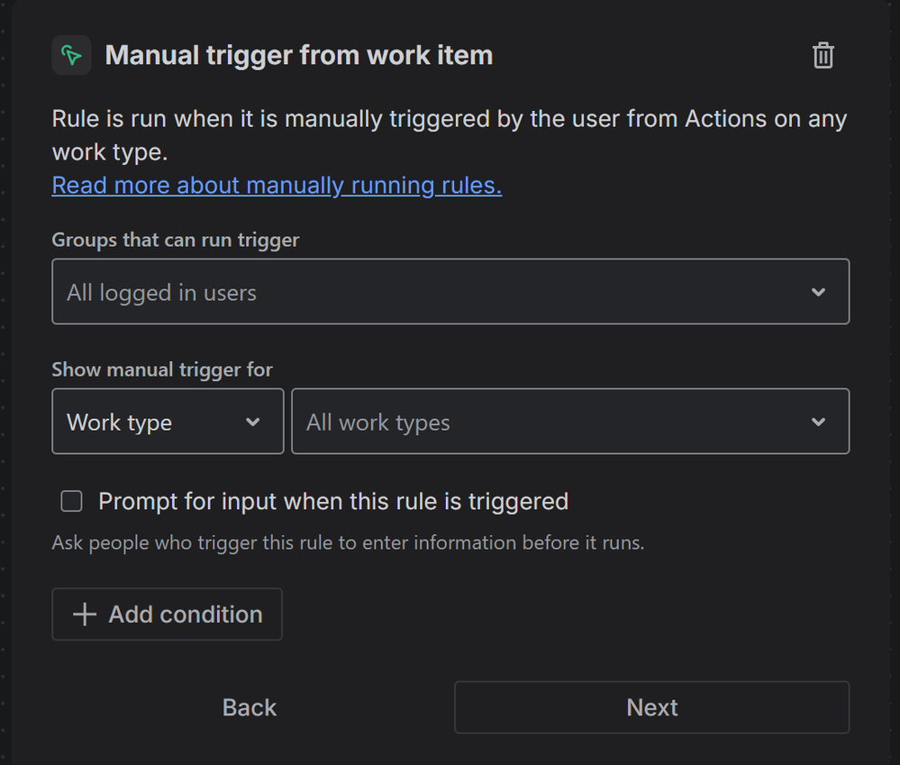

Who (via Groups) can trigger the automation, what work types and other conditions it can be triggered on are configured in the automation trigger:
I would check the trigger in the related automation. If you can trigger other manual automations from other work items in the same Space, it should be limit the issue to the specific automation trigger configuration. If you could post a screenshot of the trigger that might help guide the answer as well.

Sweta Shah
July 9, 2026
Thanks for your response.
Scope:
Manual trigger can be run by "jira-users"
"Show manual trigger for" -> Work type = "Deliverable"
Condition 1->specific reporter emailID
Condition 2->specific work-item number
1 action -> to change assignee to myself
I hope it helps to understand.
Yes, I'm testing under correct space. I tried to check the same with rule created but its automatic (i.e., trigger when work item updated, tested successfully)

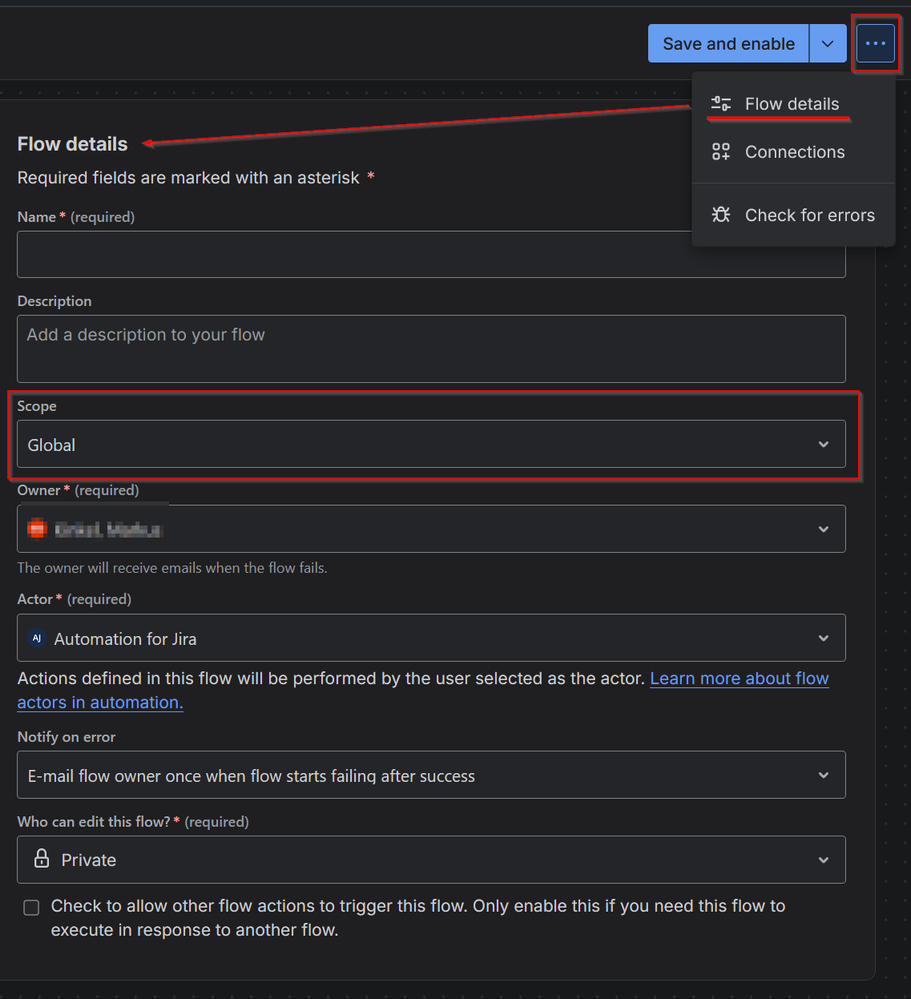

Hi @Sweta Shah
No the rule details, what is in the section where the name of the rule is defined, there you can see the rule scope.
What is the scope set too?
Markus
July 9, 2026
Hi @Sweta Shah
What Marc means is the Scope of the Flow. You can set it in the Flow Details:
Also on a side note: I'm not sure what you mean by work-item number, but if you mean the Key of the work item (TEST-123) then this Flow will only work on this exact work item and no other work item. The Key is always unique. So that might be to restrictive.
Sweta Shah
July 10, 2026
Thanks for clarification.
Scope is the programme space in which both, the work item & trigger are there.
Yes, I've specified particular key for testing purpose only.
