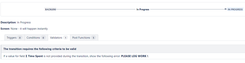

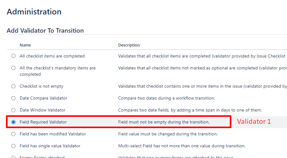

Validator 1 for "Code Review" :Field Required Validator ( Σ Time Spent)
If a value for field Σ Time Spent is not provided during the transition, show the following error: Please Work Log !

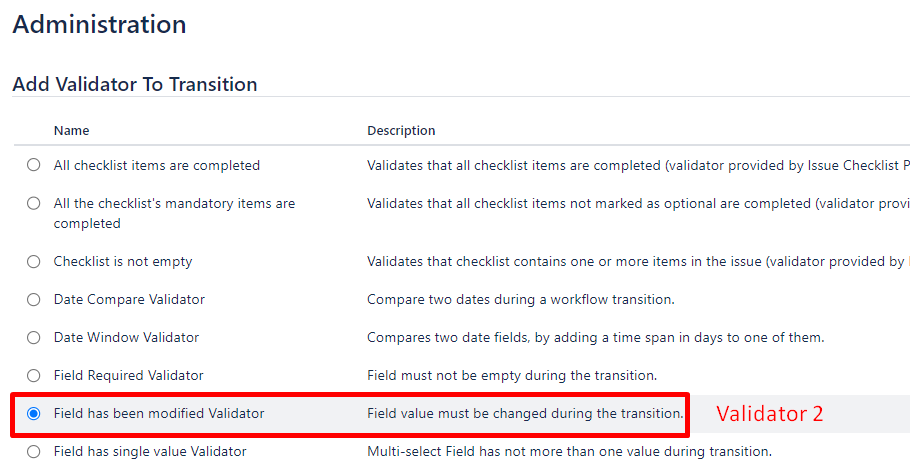

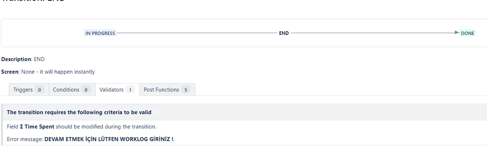

Validator 2 for "Done": Field has been modified Validator (Ī£ Time Spent)
Field Σ Time Spent should be modified during the transition.
Error message: Please Work Log!
I tried many combinations but it doesn't work. (Time spent, Log Work ...)

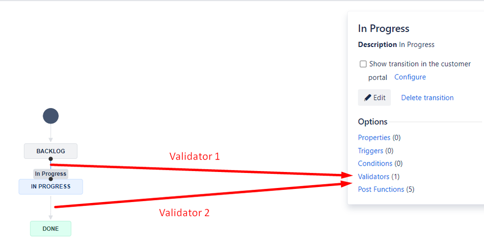

I'm testing it on a simple project so that my main project is not affected. I implemented the following flows in the same way. During the backlog phase, I entered a 1h worklog. Afterwards, I entered the 1h worklog in the In progress phase, but it gave a warning and it did not progress. It did not reach Done status.
@Fazila Ashraf @Craig Nodwell

1 - There is no "Log Work" option in "Field Required Validator". There are time spent options.
But there is a "Log Work" option in "Field Has Been Modified Validator". But I cannot use this instead of the first validator, it gives a warning even if there is log data.
