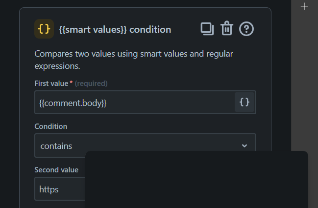

I am attaching the current configuration which I am currently using. Is there any better approach that you wanna share

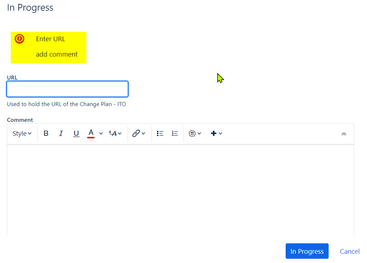

First, add a new screen in Jira without adding any fields to it, as the comment field will be added by default.
Next, include the newly added screen in the workflow transition screen. Then, navigate to the Validators section in the workflow and choose Field Required validator. Within this validator, select Comment as the required field for transition and provide an error message.
Finally, publish the workflow so that it functions as expected.
Now, if you want to capture a URL, you can use any existing custom field of type URL or create a new one and add that to the screen you created and also add a validator to make it mandatory.  For example, I have created a transition screen below while transitioning from To Do to In progress and it does not let me transition unless I provide the input.
Refer this post for reference.

Using Jira Expression Validator, you can write following expression:
let lastCommentIndex = issue.comments.length -1;
issue.comments[lastCommentIndex].body.plainText.includes('https')
or even using regex for urls
let linkReqex = 'https?:\/\/(www\.)?[-a-zA-Z0-9@:%._\+~#=]{1,256}\.[a-zA-Z0-9()]{1,6}\b([-a-zA-Z0-9()@:%_\+.~#?&//=]*)';
issue.comments[lastCommentIndex].body.plainText.match(linkReqex) != null
