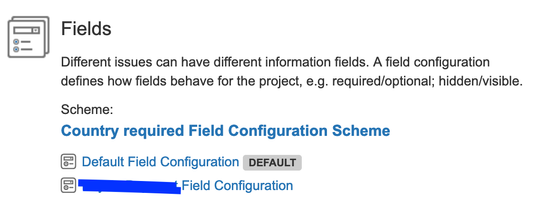

Making a field required for Story makes it required for Sub-task as well. In my project's Field Configuration Scheme I have 2 field configurations: a Default Field configuration where my field is not required - this is for all unmapped issuetypes where Sub-task is included. The second Field configuration is associated with Story and it has my field required. What am I doing wrong? Thank you!

laura iacob
October 19, 2020
I have made some screenshots.
In Project settings I can see my field configuration scheme. I will call the second field configuration (the one I painted over) Blue Field Configuration:
When I click on Country required Field Configuration Scheme I get the 2 configurations and their mapped issue types:

laura iacob
October 19, 2020
I managed to figure it out. When I try to create a Story, the Country field is marked with asterisk while on creating a Sub-task it's not and it's requested only when I try to submit it. It was about validators in the Create transition which I didn't know about
