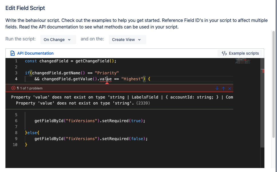

Hello @Jane Ellis

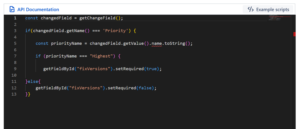

I have tried the same script and a similar script from this Youtube video.
https://www.youtube.com/watch?v=T_22rKXWNrg
In both cases I am getting this error:
"Property 'value' does not exist on type 'string | LabelsField | { accountId: string; } | ComponentsField | { accountId: string; } | IssueTypeField | { version: 1; type: "doc"; content: unknown[]; } | ... 9 more ... | { ...; }'. Property 'value' does not exist on type 'string'."

Following the video I linked above, I removed the line about checking the changed field type.
I tried using both "value" and "name" as the attributes after "getValue()" and got the same error message.

@Trudy P Claspill ! Thank you so much for that youtube video!! It was a HUGE help! In piecing the two scripts together (the one from your initial comment), I was able to accomplish what I needed!!! See below (I know there is an error, but it still works!):
That is GREAT!!
It is good to know that even though the code shows an error, it actually executes correctly.

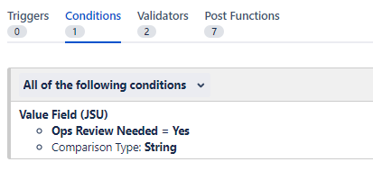

I have accomplished this using jira workflow conditions and validators.
If my condition checkbox called "needs ops review" is checked, then the field "ops reviewer" is required (validator).
I should clarify -- if they don't provide the required field then the workflow step won't get completed (in your case, "create issue."
@Crystal Baker it looks like you're achieving this with an app, JSU. I don't have the ability to purchase that right now and already have scriptrunner installed. The conditions and validators "out of the box" don't work the same way.
