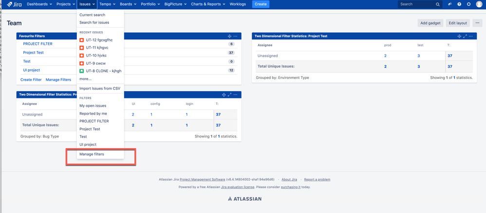

Hi @border_water ,

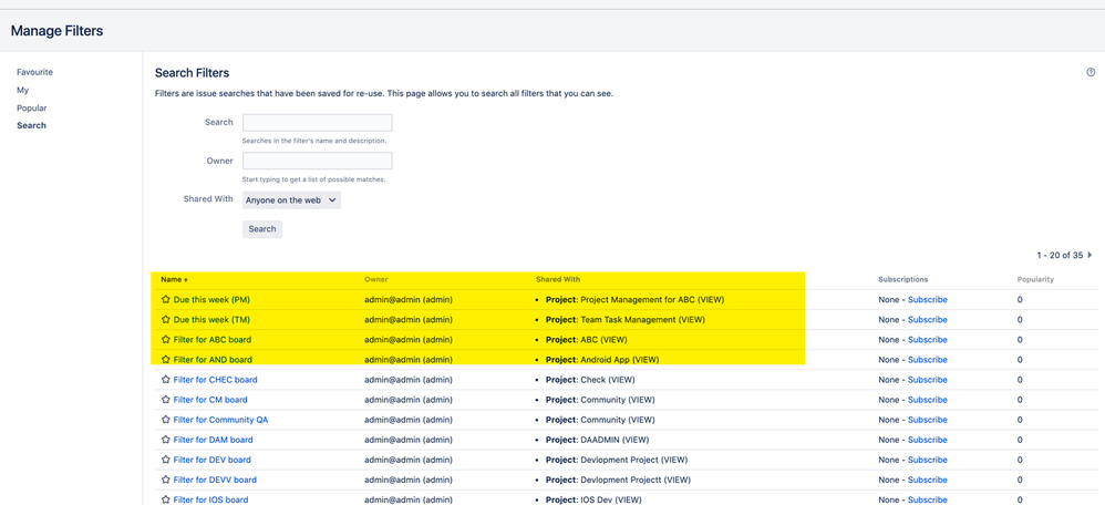

Please check all mentioned filters are shared with other users or not. Please refer below screenshot to check whether filter is shared or not.

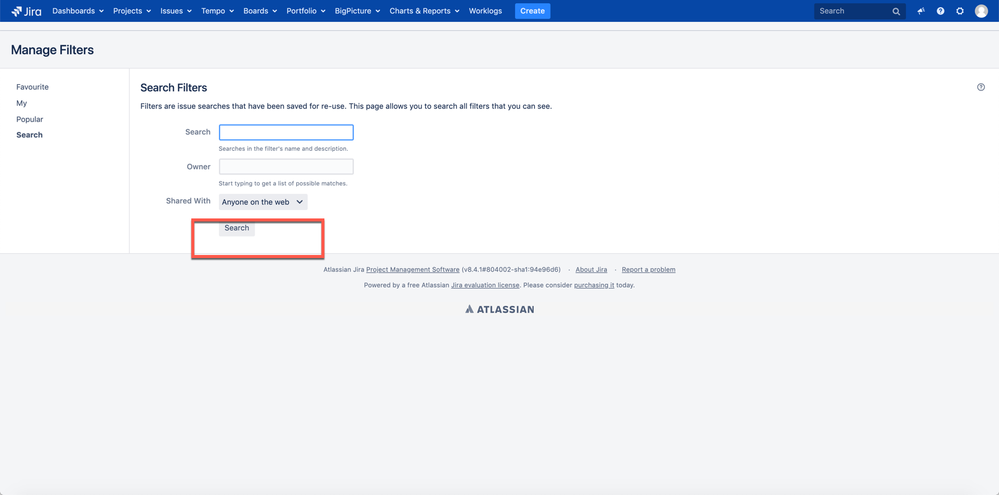

1. Click on Issues > Manage Filters
2. Serach All Filters and check all your filters shared with users are not.

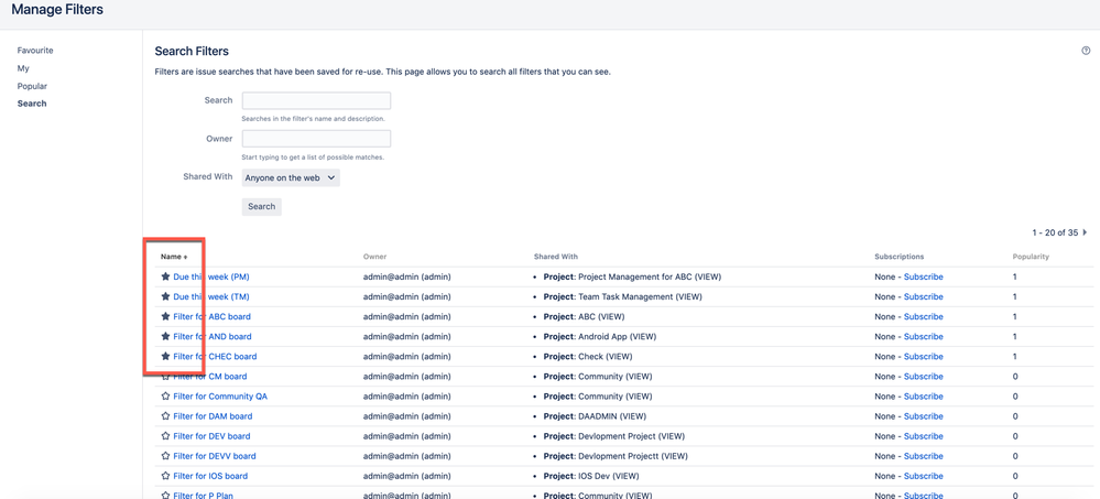

Also users need to follow above two steps and mark these filters as favourite by clicking star icon. Users will be able to view the filters only when they mark as stars that is favourites.

border_water
November 5, 2019
Thank you Avinash.
It works when other users mark my filters as Favorite as you suggested.
Thank you for your help.

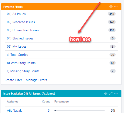

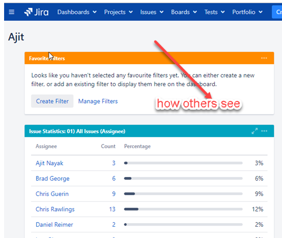

border_water
November 4, 2019
Thank you Avinash.
Still my problem remains unsolved.
I have created a Dashboard for my team with few gadgets including this 'Favorite Filter' gadget. My intention is all users in the team should be able to see the Dashboard with all gadgets including the 'Favorite Filter' gadget.  But they cannot see this 'Favorite Filter' gadget, they can see other gadgets though.
This 'Favorite Filter' gadget contains the metices like "Total Number of stories in a sprint", "Number of Unresolved Stories", "Number of Resolved Stories", "Number of Stories without Story points", etc.
Avinash Bhagawati _Appfire_
November 4, 2019
Hi @border_water ,
Can you please confirm whether users seeing Favourite filter gadget as blank space or any error in gadget view. If error , proving screenshot help in troubleshooting
