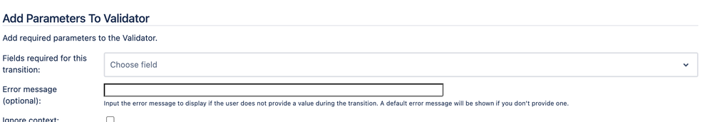

Magdalena Zhisheva
March 22, 2023
Hi @Eduardo Rodrigues ,
When you try to setup the validator, there is an optional "Error message" field. Fill the message you want the users to see if they don't fill the epic link.
Hope it helps!
