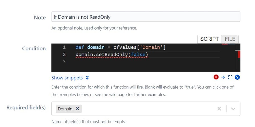

I have a Field called "Domain" - need to make it required when it is not set to ReadOnly.
For specific workflow transition. Am trying to do this using "Field(s) required validator".
Am attaching the Screenshot for the same. Am not knowing if am doing the right way. Please guide me.Screenshot 2022-08-26 105023.jpg

Your approach will not work because the method setReadOnly is only usable in the Behaviour and not in Validators.
For your requirement, why not just add a transition screen? And for that transition screen, you can use the Behaviour to set the field to required and editable. Using this approach, you can use Behaviour to validate to ensure that the value of the field is added.

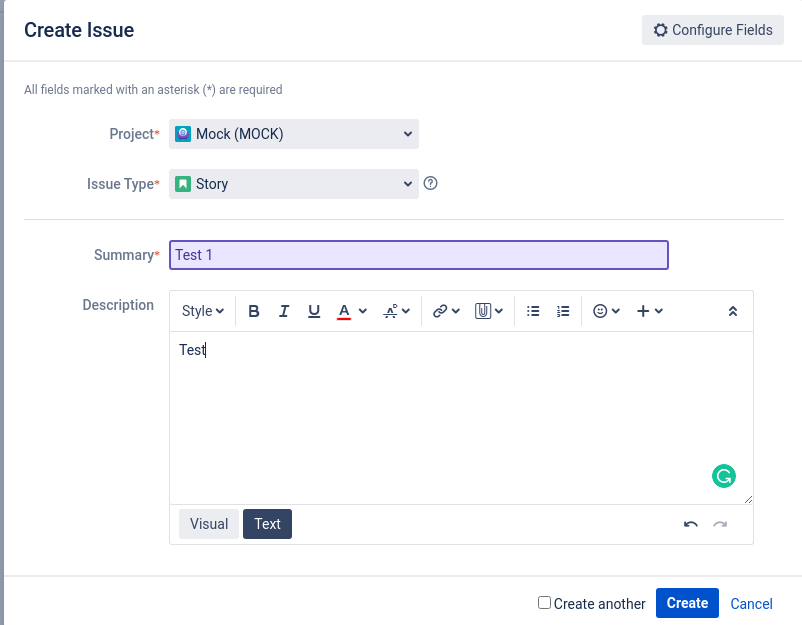

1. First, when creating a new issue, no value is added to the Sample Text Field, as shown below:-

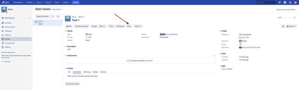

2. Once the issue has been created, it will be transitioned to the Done status.

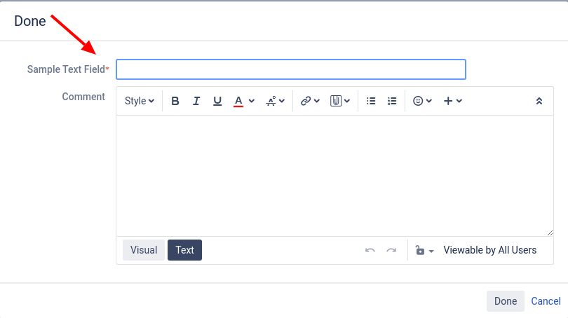

3. Once the Done button is clicked, the Done transition screen appears, and in it, the Sample Text Field is added. Now, the field is editable and is set to required, as shown below:-

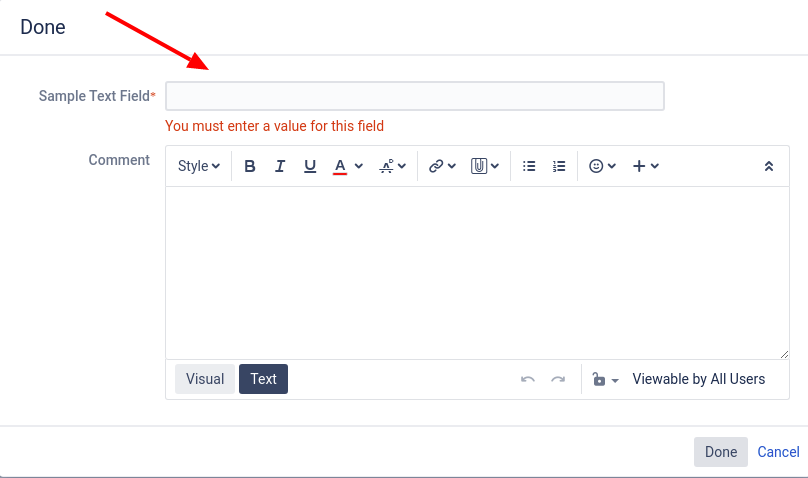

4. If I try to close the issue without adding any value to the field in the transition screen, as expected, the validator returns an error message saying that the value for the field is required, as shown below:-

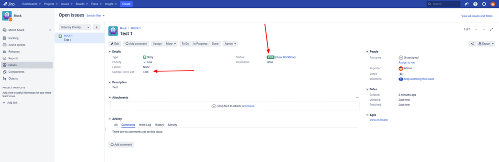

5. Once the value is added for the Sample Text Field on the transition screen, the issue can be transitioned to the Done status. Below you can see that the issue has transitioned, and a value has been added for the Sample Text Field.
