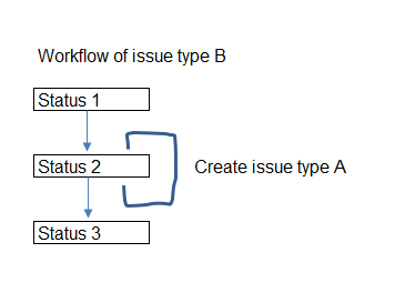

In the following case it does not work:
  1. I create issue of issue type A from inside workflow of issue type B
  2. field description is not required anymore in create screen of issue type A

hi @Anette Noll
Could you please elaborate more on the solution you've implemented to create an issue from B into A. Does B and A use the same workflow.
Awaiting your return

Hi Karim ABO HASHISH,
B and A do use different workflows. Workflow B contains Create Issue(s) postfunction. This normally works.
I have the impression that original Jira fields like description and comment, work  somewhat differently in comparison to custom fields.
Therefore in the meantime I created a custom field that works as it is intended.

May 13, 2023
Jira doesn't do "create issue" as part of a workflow.
You can create automations, listeners, and post functions to do it, but I'm not sure what you have done here, so I'm a bit stuck on what you have set up.
