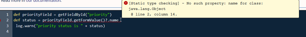

I see I use in my behaviour scripts everywhere getFormValue() iso getValue() ?
For the priority I use priorityField.getFormValue()?.name to get the priority (as text)
Deleted user
September 3, 2019
priorityField.getFormValue()?.name is not an option.
I don't have any additional options for priorityField.getFomValue()
Am I missing a specific import??

The message you get is just a compiler type check warning (the compiler does not know what object type getFormValue() returns. You can ignore it.
