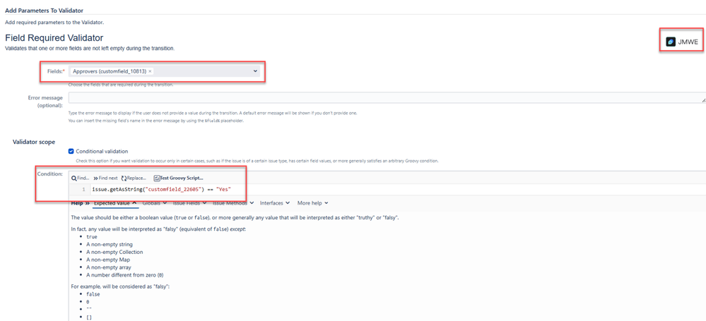

Gor Greyan
June 7, 2025
Gor Greyan
June 7, 2025
Dear @jessica.huebner , thanks for the interesting question.
If you have JMWE app, you can user "Field Requires Vaildator" with the condition, like the provided screen.
If you don't have third-party apps at all, you'd need to redesign the workflow slightly using multiple transitions and validators.
