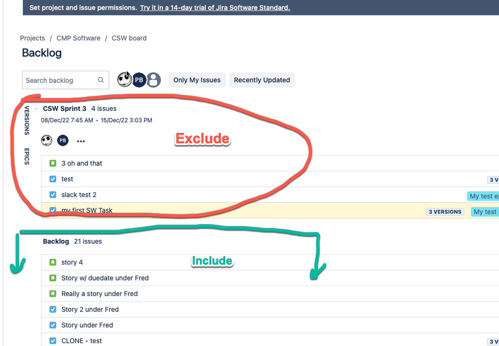

Hi @Ingrid de Bont , are you trying to achieve the results based on something similar to what I illustrate below? Specifically let's say you have some items show in your backlog that are part of an upcoming Sprint. I assume you want to exclude those? Moreover, you only want to include the true backlog as illustrated in green below. Is this the case?
Assuming so possibly the following JQL would work? However, that can be flawed as well in some corner cases, e.g. if you had an issue in the backlog that happened to be In Progress. The bottom line is it can be a bit complex depending on your circumstances. If you could give me more detail and maybe even a screenshot depicting what you want to include I could recommend further. Finally if all the complexity of the Sprint JQL stuff below is confusing let me know and I can try to explain my thinking.
project = XXX AND status = "To Do" AND type not in (Sub-task, epic) AND (sprint is EMPTY OR sprint in closedSprints() AND sprint not in (openSprints(),futureSprints())) ORDER BY rank ASC

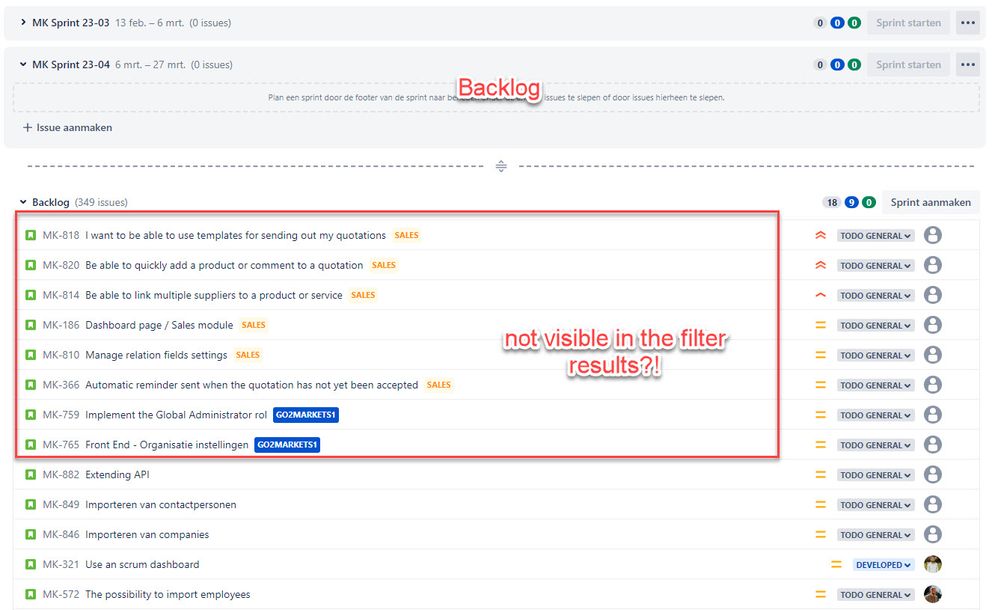

I have added a printscreen of our current backlog:jira#1.jpg

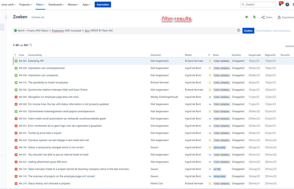

I want to achieve the same result with a filter, but I don't see the userstories associated with an epic, see printscreens.
Filter results:
