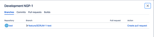

In the screenshot below, you can see the issue SCRUM-1 was correctly migrated to the Project NGP (Becoming NGP-1), however, the linked branch created before is still linked to the issue:
That being said, I can confirm that Bitbucket connections are kept after the movement with no issues, however, since we don't have any reported scenarios about this operation, I suggest you perform the steps below in case you still have any doubts about this change:
