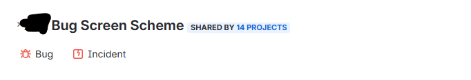

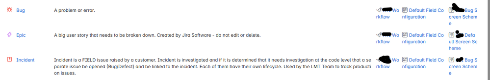

I have 2 issue types, Bugs for internal defects and Incidents for field reported defects.
Both are level 0.
Both are in the same Work Type Screen scheme
Both have the same workflow.
Both are in the same project.

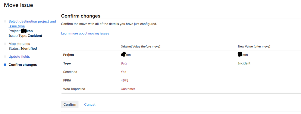

When I try to bulk change the issue type from bug to incident using move within the project I am getting the message that 3 of the fields will be cleared if I proceed.
There are no custom required fields.
If I go one by one using change the icon from bug to incident the issue type changes without warnings.
Anyone have ideas why this is happening?

PATRICIA MURPHY
August 7, 2025
This is just trying to move one issue from bug to incident.

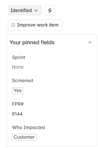

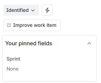

PATRICIA MURPHY
August 7, 2025
Changed issue type using just the icon change.

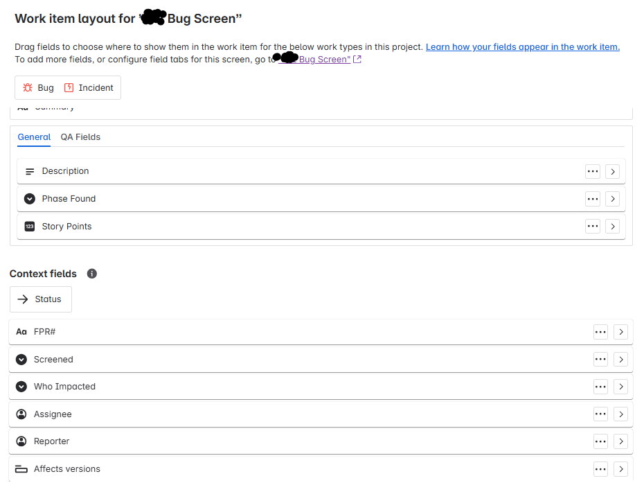

PATRICIA MURPHY
August 7, 2025
Both issue types use the same screen and layout in the project
