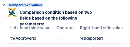

Hello,
 In Jira DC we use the apps Scriptrunner, Automation for Jira, Jira Misc Workflow Extensions and Jira Workflow Toolbox.
We are now investigating whether we can do with fewer apps and want to phase out Jira Workflow Toolbox.
Only we are now looking for the right alternative for the condition “Compare two values" ​(Comparison condition based on two fields).
Who has a good alternative condition for us?
Regards, Marco

Hi @Marco Brundel
You can use JMWE's Build your own condition with a very simple script: such as
!issue.customfield_12345 || !issue.customfield_12345.some(u => u.accountId == issue.reporter.accountId)
You can use the issue fields help tab below the script editor to figure out the custom field id.
