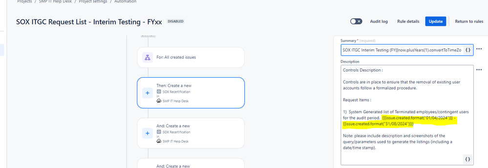

G Ashok
August 5, 2024
I am trying setup the dates in Automation Description Please see below Image
Samuel Gatica _ServiceRocket_
August 5, 2024
Hi @G Ashok
For reference please check https://support.atlassian.com/cloud-automation/docs/jira-smart-values-date-and-time/
The Smart Value {{issue.created}} retrieves the creation date of the triggered issue. If you wish to format this value, you can utilize {{issue.created.mediumDate}}.
Additionally, using {{issue.created.format("04/01/2024")}} will establish a fixed date in the Description as 04/01/2024.
Example of {{[date].[dateformat]}}
  • {{now.jiraDate}} //returns 2020-08-18
  • {{issue.created.mediumDate}} //returns "Aug 8, 2024
  • This issue was created on {{issue.created.format("dd/MM/yyyy")}} //returns This issue was created on 18/08/2020
  • This issue was updated at {{issue.updated.shortTime}}. //returns This issue was updated at 2:40 AM.
Are you attempting to retrieve the time period from a custom field in the issue?
Best regards
Sam
