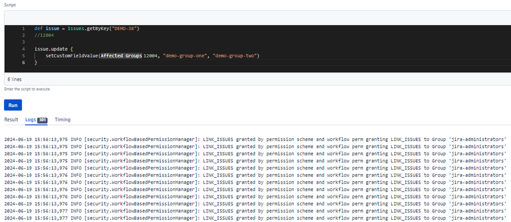

I was playing around with the Scriptrunner HAPI syntax and got some logs in the Console log section. What I tried to do is to simply update an Issue and set some values for a multi group picker field, what I got was a correct update on that issue, but Scriptrunner also threw some strange logs. Does anyone know what this is about?
My HAPI code in this example was:
def issue = Issues.getByKey("DEMO-38")
issue.update {
    setCustomFieldValue(12004, "demo-group-one", "demo-group-two")
And the log output (exceeding the 300 lines limit, these same lines have been repeated over and over again, when I checked the logs I could find a total of 398 lines with that output):
2024-06-19 15:36:33,385 INFO [security.WorkflowBasedPermissionManager]: LINK_ISSUES granted by permission scheme and workflow perm granting LINK_ISSUES to Group 'jira-administrators'
So I went into the Permission scheme of that project, and checked for the Link Issues permission. What I noticed is:
  • 'jira-administrators' have the link issue permission
  • when I remove the group from that permission, the logs do not appear with the next update attempt, the group is not added to the permission (still ok)
  • When I add the 'jira-administrators' group to the permission again, and run the code, the logs happen again
Any ideas what is happening there, and why?

Hey @Marko Slijepčević
The logging you see is unrelated to HAPI, you would see the same logging if you used the IssueService class from Jira directly, which is what HAPI calls into.
ScriptRunner will output any logs from the Atlassian application that occur during the script execution. The logs that get shown are a result of the Log4j configuration of the instance.
To quieten down the logs, you will probably want to tweak your Log4j configuration: https://confluence.atlassian.com/adminjiraserver/logging-and-profiling-938847671.html
Make sure to check the docs for your exact Jira version, as newer versions of Jira use Log4j2, and older versions use Log4j 1.
If you need further assistance with this, could you please raise a support ticket with us, so we can give more tailored advice?
