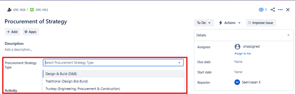

In my JWM project, I have a dropdown field called Procurement Strategy Type with three options. When a value is selected, Jira Automation automatically creates the corresponding subtasks. However, if an incorrect value is chosen and later corrected, subtasks for both the incorrect and correct selections remain.
Now, I need to lock the field after a value is selected so that it cannot be edited further. Is this possible, or would you recommend an alternative solution that better suits my requirement?
