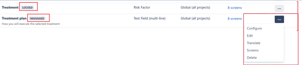

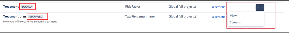

Hi Team,
We have field name called "Treatment:, it came up with addon "Risk Register". By mistake I unlock this field to check something using script mentioned in this scrip runner document.
https://confluence.atlassian.com/jirakb/unlock-a-locked-jira-custom-field-using-scriptrunner-1167828785.html
When I ran the second script to unlock, the field "Treatment" is moved from "Managed" tag to "Locked". With "Managed" tag, I can configure the field, but not with "Locked". Is there any possibility to put it back from "Locked" to "Managed" ?
Please find the attached screenshots for your reference.
Before change :
After Change :

Solution : It worked.
If we run the second script again but change ConfigurationItemAccessLevel.LOCKED to ConfigurationItemAccessLevel.ADMIN this should return the field to 'managed' and allow edits to be made.
