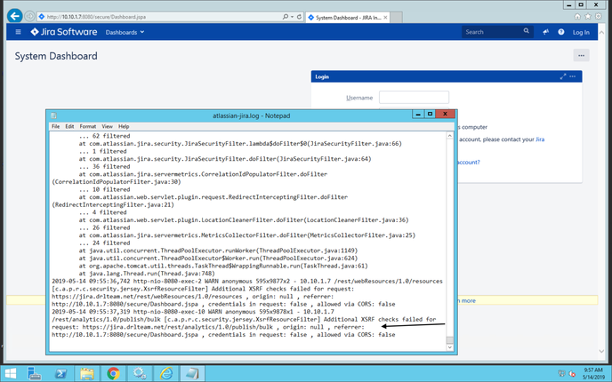

I'm having an issue after upgrading from Jira Server 7.6.1 to Jira Server 8.1. After the upgrade I replaced the server.xml file with the one I used in 7.6.1 in order to retain my proxy server settings. This worked and users are now able to login on the HTTPs portion of it but when I as an admin attempt to login on the backend HTTP localhost site the screen flashes once and goes back to the login page. The credentials arent wrong because when I purposefully type in the wrong password it tells me that my username/password are incorrect. This issue doesn't tell me anything but redirect me to the login page. I've uploaded a screenshot of what the logs say after this occurs.
Hope this helps. Any assistance would be appreciated; Cheers.

Hi @KO89 ,
can you attach the full stacktrace?

Sure, I've attached it via this message.
Jira Atlassian Log
Didn't want to jam this message with logs so I uploaded the file into my Azure storage. let me know if you have issues opening it.

Yes, I can open it and see the following issue:
2019-05-14 09:55:36,739 http-nio-8080-exec-18 ERROR anonymous 595x9876x1 - 10.10.1.7 /plugins/servlet/gadgets/dashboard-diagnostics [c.a.g.d.internal.diagnostics.DiagnosticsServlet] DIAGNOSTICS: FAILED
com.atlassian.gadgets.dashboard.internal.diagnostics.UrlSchemeMismatchException: Detected URL scheme, 'https', does not match expected scheme 'http'
so you should fix your configuration regarding https/http.

Roger that, the issue probably exists somewhere in my server.xml file. I'd have to dig to find it
