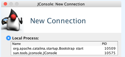

  • Which option are you choosing under Local Process?
I just went through the steps as described in the article and did not run into this issue.  Can you please provide a screenshot showing the options under Local Process:
Next please show a screenshot of and the MBeans tab's options.

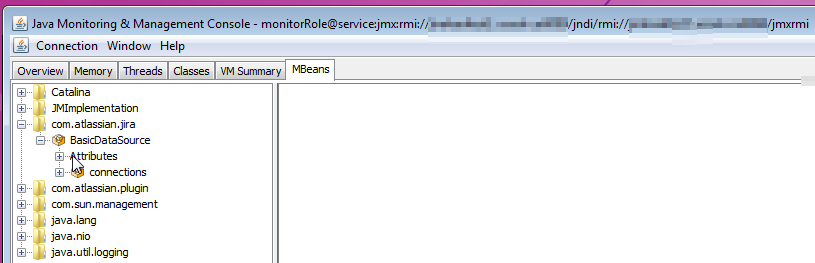

Here's a screenshot of the MBeans tab once I've connected (below).  The only choice for MBeans under com.atlassian.jira is BasicDataSource.  Am I looking in the wrong place for the metrics discussed in the article?
