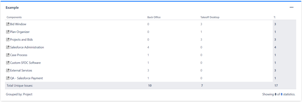

If you are using the same fixVersion across all projects, and you want to see a list of components actively in use you can do a two dimensional filter in a dashboard.  I am still not sure if this is what you are asking for, but it would look similar to this.
  • Create the filter -fixVersion = "whatever you named it" AND component is not EMPTY
  • Create a Dashboard and add the 'Two Dimensional Filter Statistics'
  • Use saved filter, XAxis - Project, YAxis - Components
  • Number of results - the max is 50 to display
 It would look like this, give you a list of components and the number of times used in each project. If you click the numbers, it will take you to a list of the tickets.

Hi @Coley Anderson ,
It worked , Thanks a lot .
