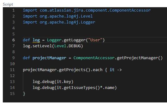

Sharing a Groovy script that worked for me (using ScriptRunner console):
Output of data is a bit clunky since it shows within the console output, but it works! Pulls issue types for all projects by iterating over the Jira instance projects.
Hope this helps as well.
