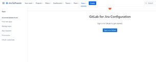

After installing the app "GitLab for Jira (gitlab.example.com)" in Jira Cloud according to the explanation "Install the application manually" in GitLab.com for Jira Cloud app | GitLab it is not possible to connect Jira Cloud and GitLab.
The connection is done as following, and worked till ~ june of 2023:
In Jira Cloud go to "Apps --> Manage your Apps --> GitLab for Jira (gitlab.example.com) --> Get started" resulting in this page:

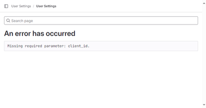

After clicking the "Sign in to GitLab"-Button and authenticating in the popup, this error is displayed:
Any help appreciated
Kind Regards
David
David Hämmerle
January 25, 2024
Solved by doing the oauth Step as Admin. Now normal users can link as many jira cloud sites as they want to their namespaces (gitlab top level groups)
