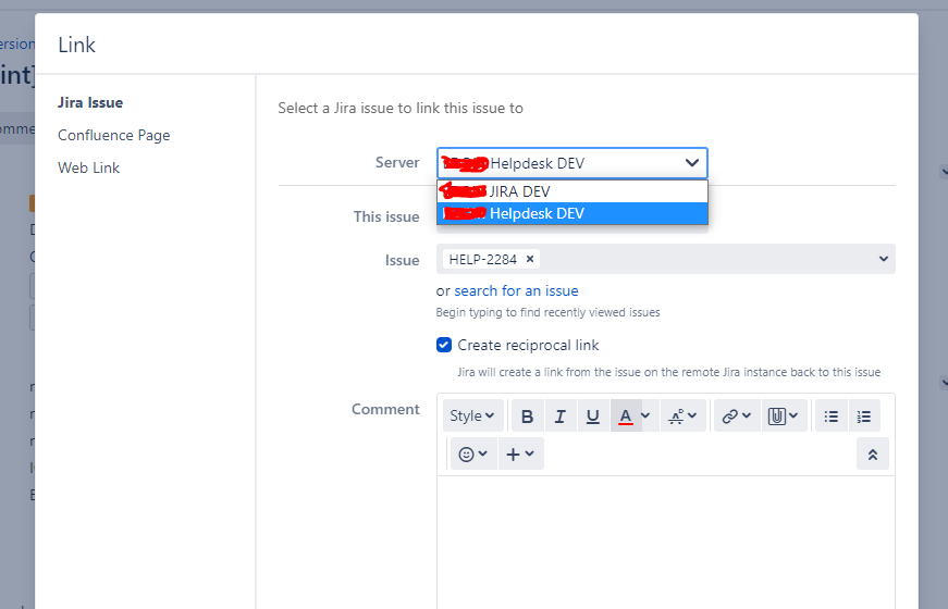

I have this case where I want to link issues between different Jira server instances. I created application link and the manual linking works as expected, with the selection of the server to and issue to which we gonna link:

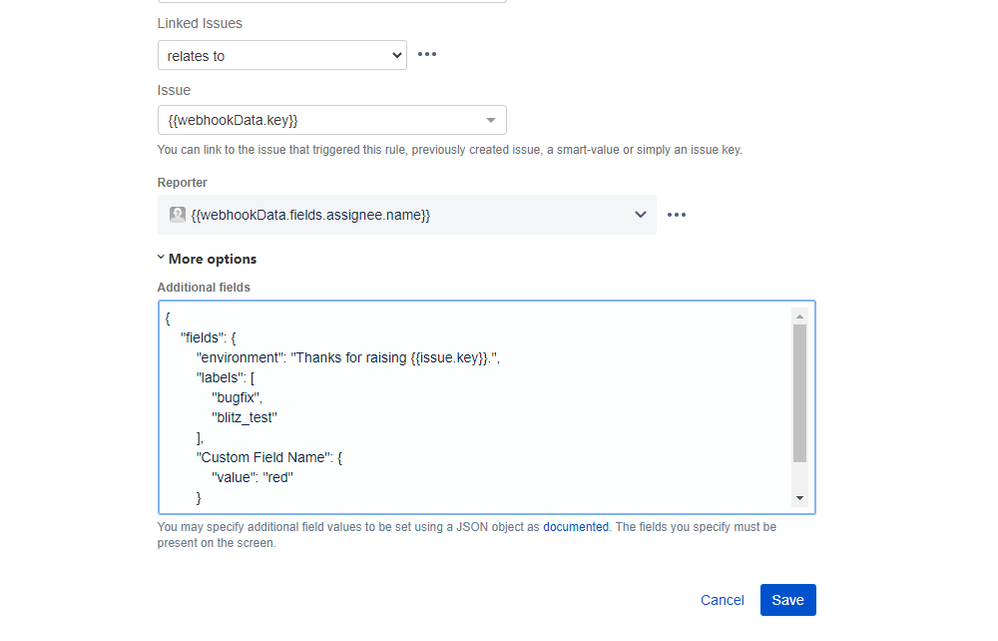

Here is the part of my webhook rule:
The smartvalue {{webhookData.key}} does not work in the automation rule, because the rule trying to find the value in the local Jira instance and not the remote, which is logical. So there should be a way to specify a server (Jira instance) where the value should be attributed, like the selection we have when manually linking issues.
Maybe it would be possible to use json codes for this? Any ideas?

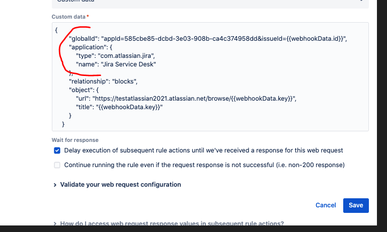

thanks for your reply and I have seen that article before. On the step 3B in that article there is clearly shown that the issue link is set up in advanced mode using JSON,
and there are some data like "globalID, "Application": "Type", "name":
I assume that some similar JSON could be done for server/DC where we can specify the Server name where the issue link should be set up. Though I was not able to do it :(

I think, these parameters should be contained in a REST API call to <JIRA_URL>/rest/applinks/1.0/listApplicationlinks.
Maybe that helps to move your forward?
