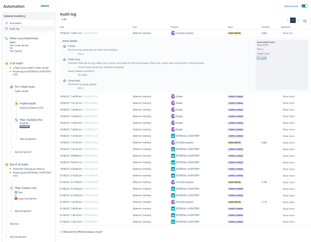

Hello,
I have an issue linking issues with automation. This error has happened to me in the past and the resolution was to check for hidden fields but this has not worked this time around as both the fields assignee and linked issues exist when I hit search for fields (see resolution in link here: https://community.atlassian.com/t5/Jira-Software-questions/My-trigger-to-create-linked-issues-is-not-working/qaq-p/2222667). Otherwise the issue is created ok it just won't link. I am able to link manually and have the right to link in both projects. Any help will be appreciated.

Can you share the solution to help other community members learn?
LouiseJ Rivet
June 19, 2023
Yes it was not configured in the screen of the origin project. Thanks!
