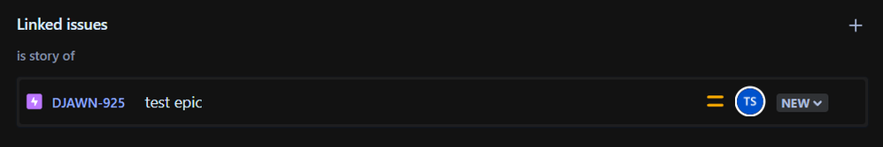

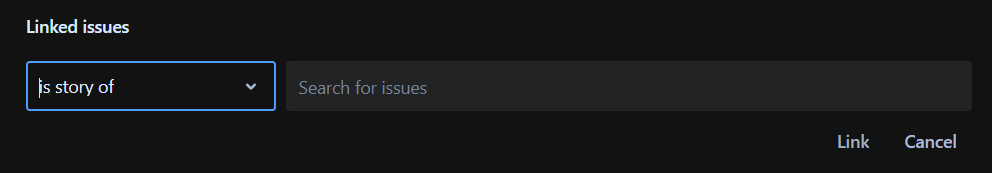

I go back to the stories and link them to the epic, using the link and link type "is story of"
I save and it looks right

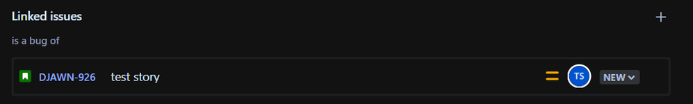

When I open the epic to verify the link, the linktype shows that it is a bug
Is there some predefined linktype value and it overrides my selected type ?

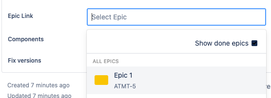

The linking between Epics and other standard issues (Stories, Bug, etc.) is established by the Epic Link field on the standard issue. Therefore you might use these two methods to get it working:

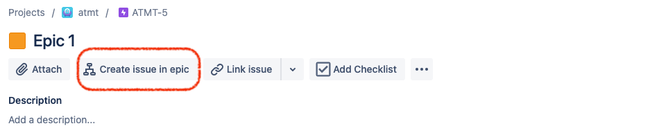

1 - Create issues from the Epic
Navigate to your Epic issue and hit Create Issue in Epic
2 - Edit the Epic Link field in the issue

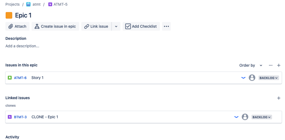

After linking issues using both the issue linking and the epic link one can note the difference when view the Epic issue:

I extracted a mapping of these link types:
Source                Target
is blocked by      blocks
blocks                  is blocked by
is story of            is a bug of
is a bug of           is story of
is cloned by         clones
clones                  is cloned by
is duplicated by  duplicates
duplicates           is duplicated by
relates to            relates to
So the story / bug link should only be used where you have a story and related bug. On other ticket types, this meaning may not make sense.
