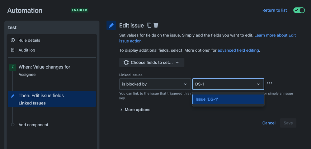

If I got it right you just want to set a specific issue to be linked, always the same.
In this case, I just tested it and you can type the issue key in the box and it works. It's not very clear from the interface, to be honest.
Of course, you can even use a smart value if you need it to be more dynamic
I hope this helps
Alexander Aruj October 3, 2023
Yep, I missed that it is possible to write in the issue explicitly because the UI is a little funky or inconsistent in this case. Thanks @Giovanni Melai !
