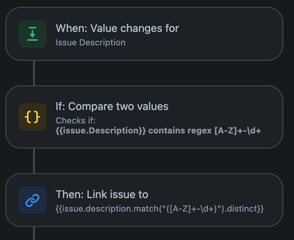

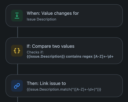

Hello! I have been trying to create an automation that links issues when they are mentioned in the description field, and I'm having some trouble. I followed the steps taken from this previously asked question, but have been unsuccessful. I have an automation that works for linking tickets that are mentioned in the comments but even with changing the JQL to access the issue description body, the mentioned tickets don't link. I'm not sure if the issue is the trigger, but I would want it to check every time the issue description is updated.
Automation that I have currently:

Thank you! I just took a look and it seems like the automation is activating, but does not do anything. The problem seems to be with the {{smart value}} condition - specifically the if condition (If: Compare two values).

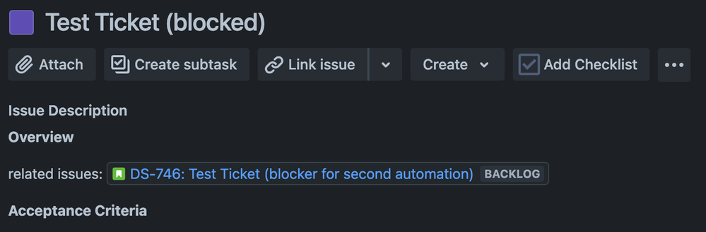

This is what the ticket looks like (ticket names are not relevant). Test Ticket (blocked) is the ticket that the automation is running on (DS-744).

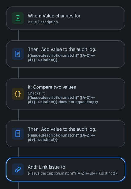

Rachel Godina
April 1, 2024

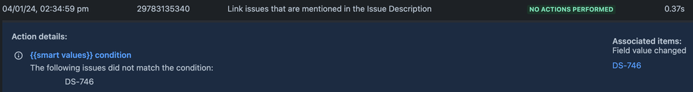

Thank you! I was able to try it and seem to be getting a similar problem as before:

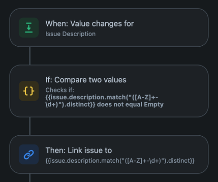

This is the updated automation:
Do you believe that I would have to use the distinct parameter in the if condition?

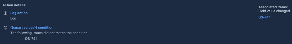

I apologize, I'm not sure what you mean by writing the expression to audit log before the condition, do I use something like the "log action" condition? I have used a smart value condition as well:

Rachel Godina
April 2, 2024

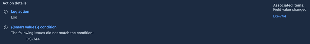

Okay, I added two log action conditions with the
{{issue.description.match("([A-Z]+-\d+)").distinct}}
and it seems to not log anything. I believe only the first log action condition is running which I assume means there is something wrong with the expression since it isn't going through the if condition(?) and nothing is logged. Could be be a problem with the regex?
Screenshot 2024-04-02 at 10.55.30 AM.pngScreenshot 2024-04-02 at 10.55.55 AM.png

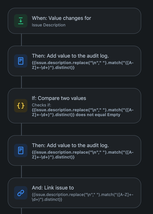

Rachel Godina
April 2, 2024

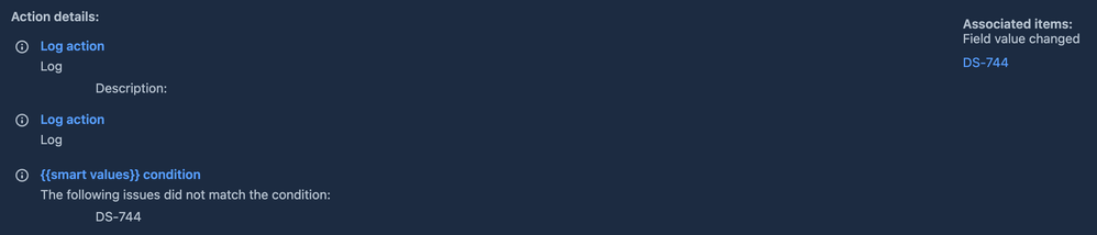

I changed all the expressions to match the one you just made but unfortunately, the audit log responded the same as before.
Screenshot 2024-04-02 at 11.46.24 AM.pngScreenshot 2024-04-02 at 11.46.49 AM.png
Here is exactly what is currently in the issue description for the issue I'm testing. All the text is "normal" type. There are no headings used in the ticket descriptions. Maybe there is an issue with the bold letters, but the link is not in bold so I assume that is not the problem:
Overview
related issue: [link to secondary ticket]

Rachel Godina
April 2, 2024
Unfortunately, it seems to be getting nothing from the issue description - I tried it with the "d" in description being capitalized as well (which was how it was in the forum post I mentioned before) but it gave the same result.
