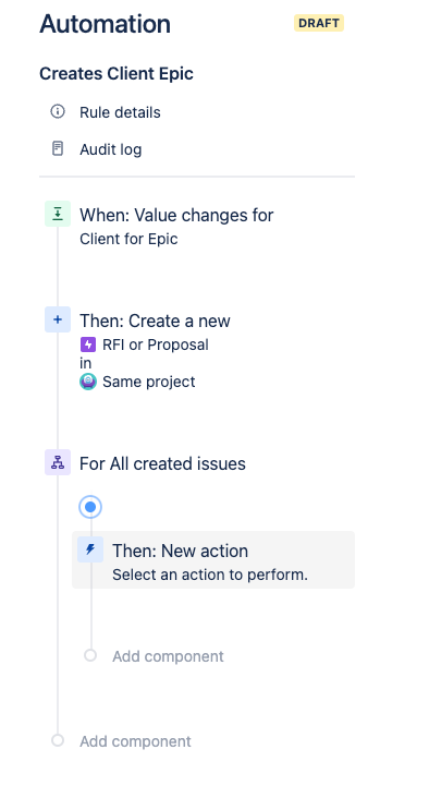

So here's the deal.
I have it set up so that if employees of my workplace email a particular domain it creates an issue on my board.
What I'm trying to set up is so that if I change a field in that ticket it does the following:
1) Checks to see if an Epic with the same value as the field already exists
2) Creates an Epic ✅
3) Copies the fields of the issue into the created epic ✅
4) Automatically sets itself as the child issue to the newly created Epic
Can anyone help with this?
The green checks are what I've been able to figure out in the flow on my own.

Jack Wiltshire
December 1, 2022
Hey, Not sure what either of those terms means ill be honest. I manage the project myself and it's solely used by me, it's used for non-technical use in creating a task for me to complete regarding compliance and bid proposals.
This is where I get stuck:Screenshot 2022-12-01 at 20.39.53.png

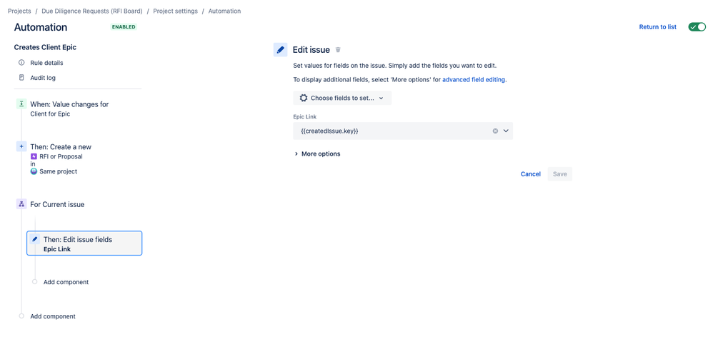

Okay figured it out!
4) Automatically sets itself as the child issue to the newly created Epic ✅
Did that using {{createdIssue.key}} as recommended thank you for that!

I'm dubious about your answers that
- the project is Team Managed and
- that you were successful in making the issue a child of the new Epic by setting the Epic Link field and
- that you want to compare the text in Client for Epic to the Epic Name field of existing Epics.
Epic issues in Team Managed projects don't use the Epic Link field to connect a child issue to an Epic, and they don't use the Epic Name field.

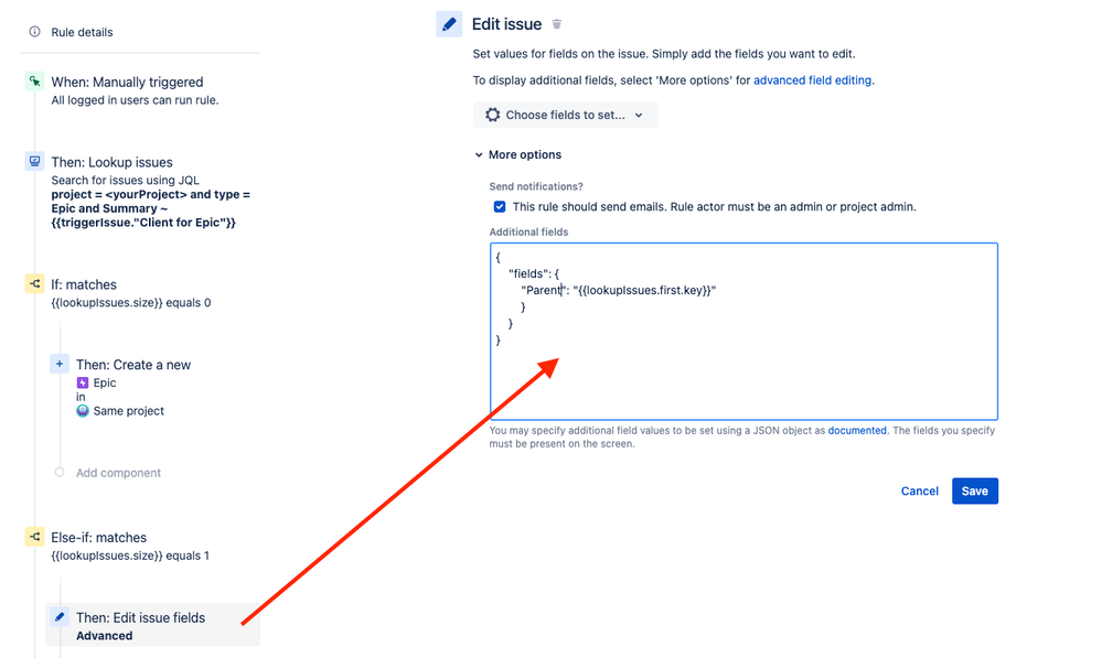

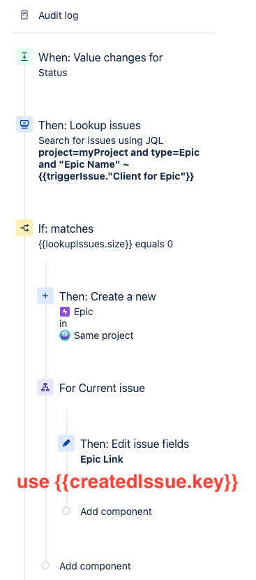

Can you show us the Automation Rule in its current state, and the Audit Log details for an execution where the issue was successfully made a child of the new Epic?

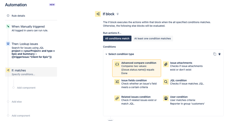

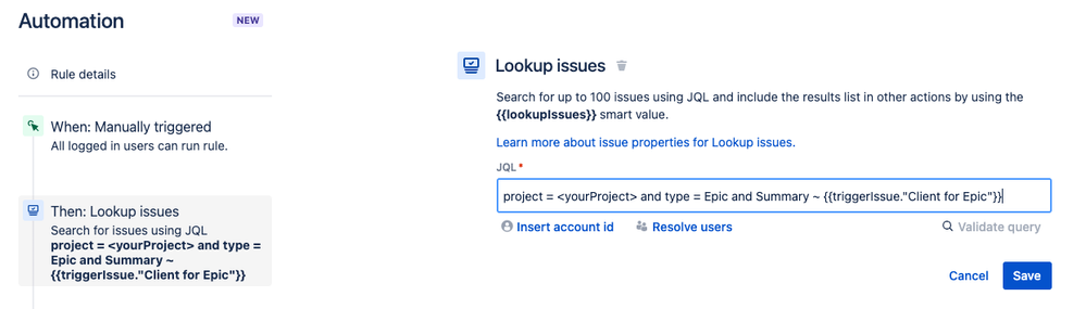

Regarding the step to figure out if an Epic already exists, I would recommend you use the Lookup Issues action with a JQL statement to search for any Epics where the Summary field (because Epic Name isn't used in Team Managed Epics) contains the text in the "Client for Epic" field.

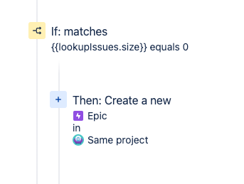

Follow that with an If/Else block with an Advanced Compare to check how many results are returned by the Lookup Issue action.

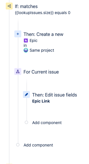

If the result set size is zero (no epics that match) then execute the components to create an Epic and make the issue a child of the new Epic.

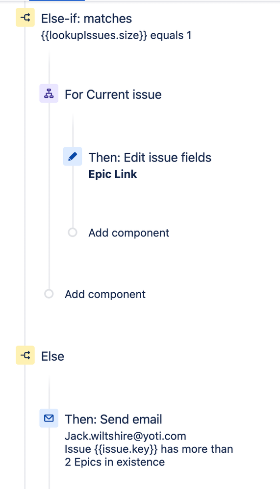

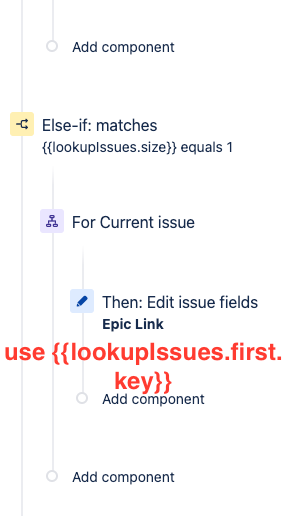

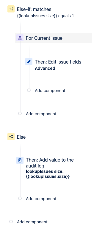

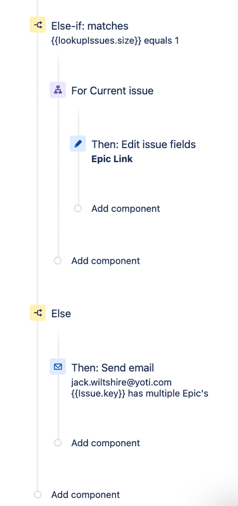

Follow that with an Else-If to check if the result set size is 1 (one matching Epic found) and add steps to make the issue a child of the found Epic

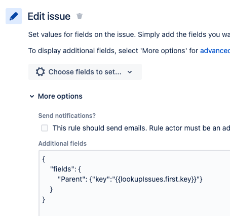

You have to set the Parent field because in Team Managed projects that is the field in the child issue that is used to keep track of the parent Epic.
The tricky bit here is what happens if the Lookup Issues results contains more than 1 match. You can either add an Else to take some actions in that case, or you can make the previous block a simple Else (rather than Else-If). In the former maybe you want to send yourself an email to look at the new issue and manually link it to an Epic. In the latter choice your rule would end up reporting success but neither creating a new Epic nor linking the issue to an existing Epic.

Trudy Claspill
December 2, 2022
Substitute "Epic Name" for Summary and you can use a simple Edit Issue action to set Epic Link.

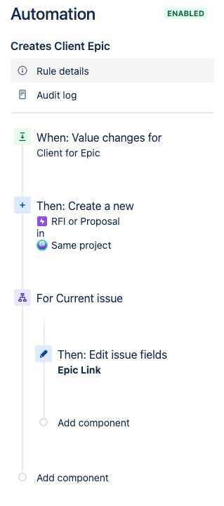

Jack Wiltshire
December 2, 2022
Thanks!
Sorry if this seems silly but how would I fit that into my existing automation string?
Trudy Claspill
December 2, 2022
Please post a new image of your Automation Rule as it currently is configured.
Jack Wiltshire
December 2, 2022

The new structure for the rule would look like this:
(Ignore the field I'm checking in the trigger)

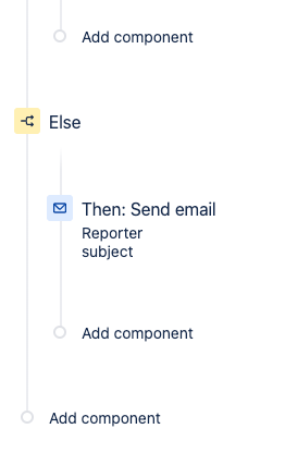

Whats the part about the email at the end?
EDIT:
Tried this and the audit log states it was successful however upon testing it would still create a new Epic even if there was an existing Epic with the same name :(
Cheeky ask, but is there any chance I could arrange a short video call with someone to help me through this?
I sincerely apologise for my "noob-ish" experience with all this.
Trudy Claspill
December 3, 2022
The first IF is to check if there were no matching Epics. If none were found, create one.
The IF-ELSE is to check if exactly one matching Epic was found. If so, link the issue to it.
The ELSE is where it goes if more than one matching Epic was found. If that happens, I didn't know what you would want to to, so I plugged in a Send Email component. You can send an email to yourself to let you know that multiple potential matching Epics were found, so the issue wasn't linked to anything and needs to be reviewed and linked manually.
You would need to fill in to whom the message should be sent. And you would probably want to put into the message content the ID of the issue that triggered the rule so you would know which one needed to be checked.

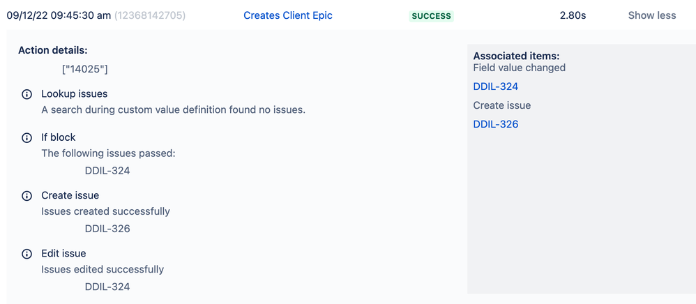

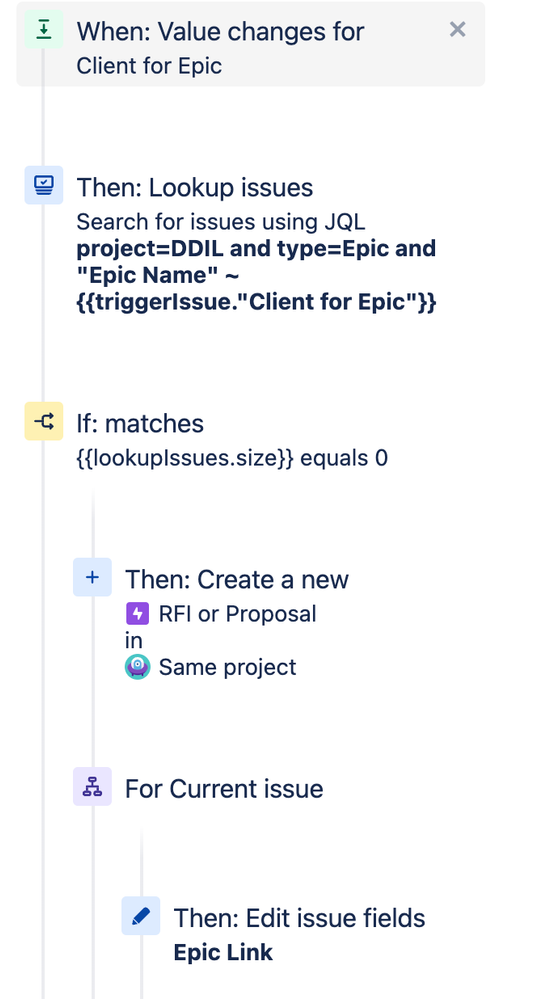

Jack Wiltshire
December 4, 2022
Still no luck I'm afraid.
At least the linking when created it working now, I guess I can keep an eye out for duplication manually.
unless you can see any blaring mistakes on my part?
Trudy Claspill
December 4, 2022

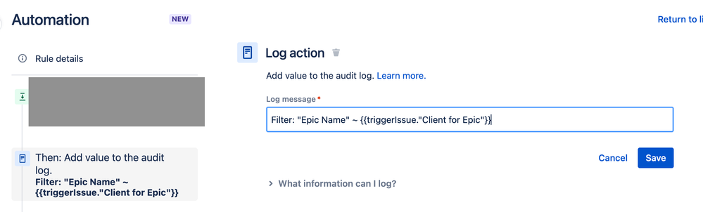

If it is not linking when an epic already exists, what are the results of the filter for ?
"Epic Name" ~ {{trigger."Client for Epic"}}
Use a Log action to print that out into the rules Audit Log to see what is actually being used by the Lookup Issue action
Insert that before the Lookup Issue action.

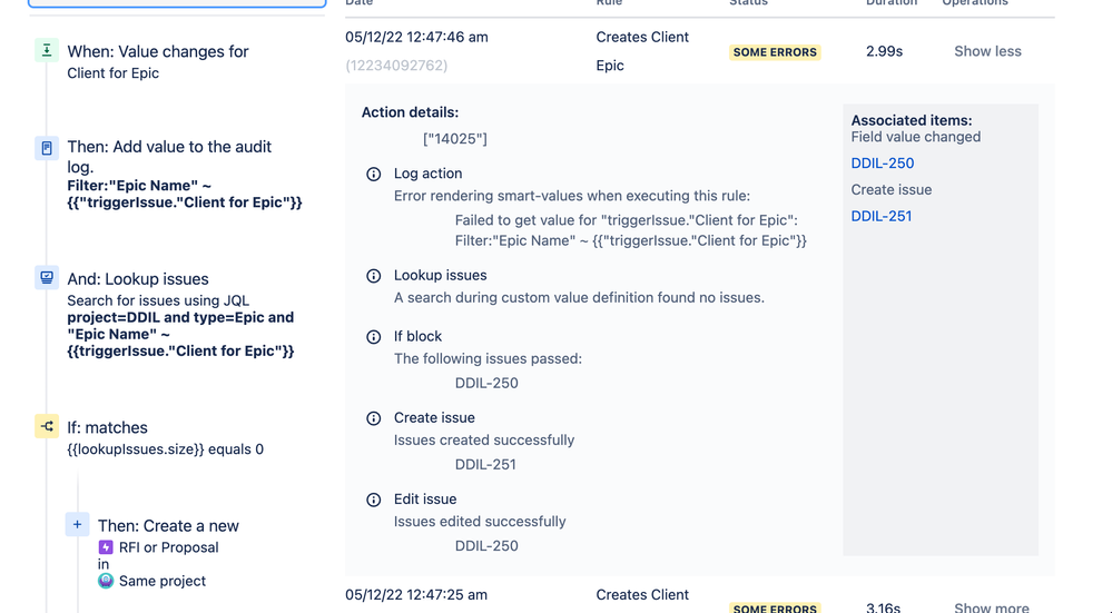

Jack Wiltshire
December 4, 2022
The hope is to get it to link when an epic already exists, it's just not doing it haha.
This is what the log message pulled:
Trudy Claspill
December 5, 2022
You have an extra double-quote in front of triggerIssue

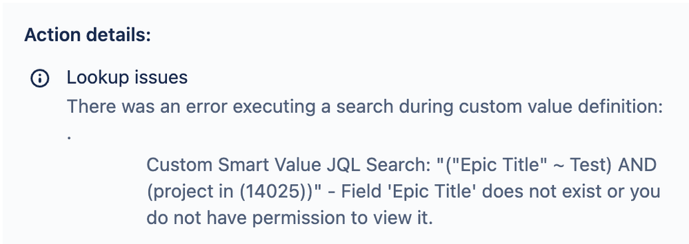

Jack Wiltshire
December 6, 2022

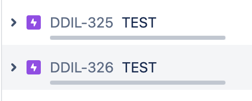

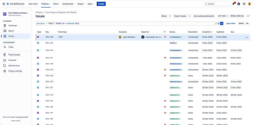

Lots of issues come up, but none belong to me or my board: Screenshot 2022-12-06 at 21.58.59.png
Trudy Claspill
December 6, 2022

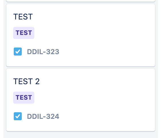

Can you provide a screen image from the View All Projects screen that shows this project you're working with (DDIL) and the column that says if it is Company Managed or Team Managed?
Can you show us a screen image of the Epic in this project that include "TEST" in the Epic Name field?
Jack Wiltshire
December 7, 2022
Sorry, i have already deleted the "TEST" now as to prevent clutter on the board but I do have this screenshot if this helps.
I have whited over any business details that need to remain confidential.

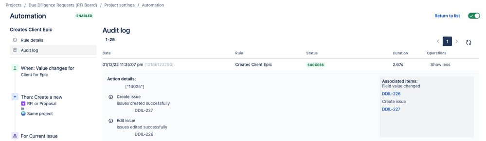

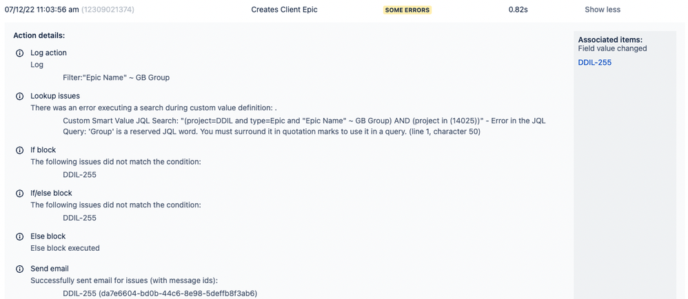

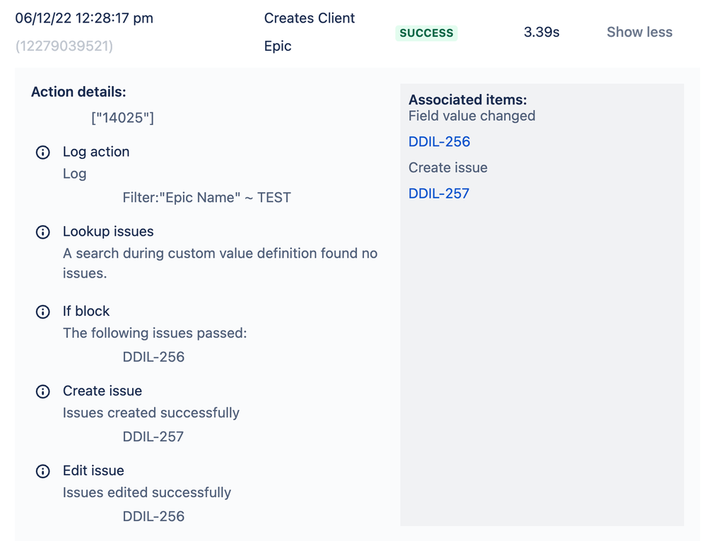

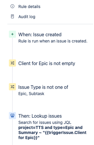

Jack Wiltshire
December 7, 2022

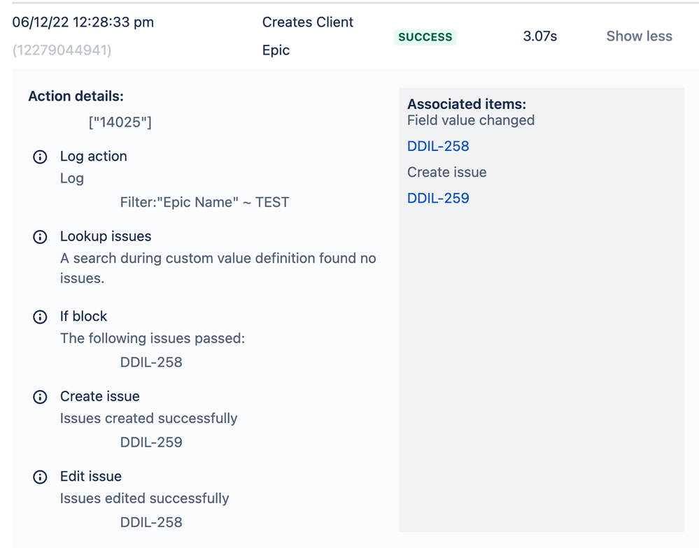

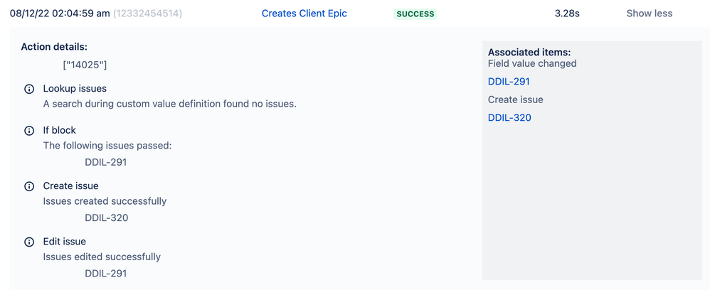

Oh, I also had this with one of the attempts:
Trudy Claspill
December 7, 2022
Looking at the first screen image I can see that indeed the DDIL project is Team Managed. In that case, the Epics in a Team Managed project don't use the "Epic Name" field and your comparison needs to use the Summary field instead.
For the second image showing the audit log, if the text that is in the Client For Epic field includes spaces in it then you will have to enclose it in quotes in your Lookup
Summary ~ "{{triggerIssue.Client for Epic}}"
And you don't need the quotes inside the curly braces around Client for Epic.
Also, given that the project DDIL is a Team Managed project, setting the "Epic Link" field to make the issue a child of the Epic should not work. Those projects don't use the Epic Link field.
I would love to see the audit log and Epic issue details for a case where this rule caused a new Epic to be created and made the triggering issue a child of the newly created Epic.

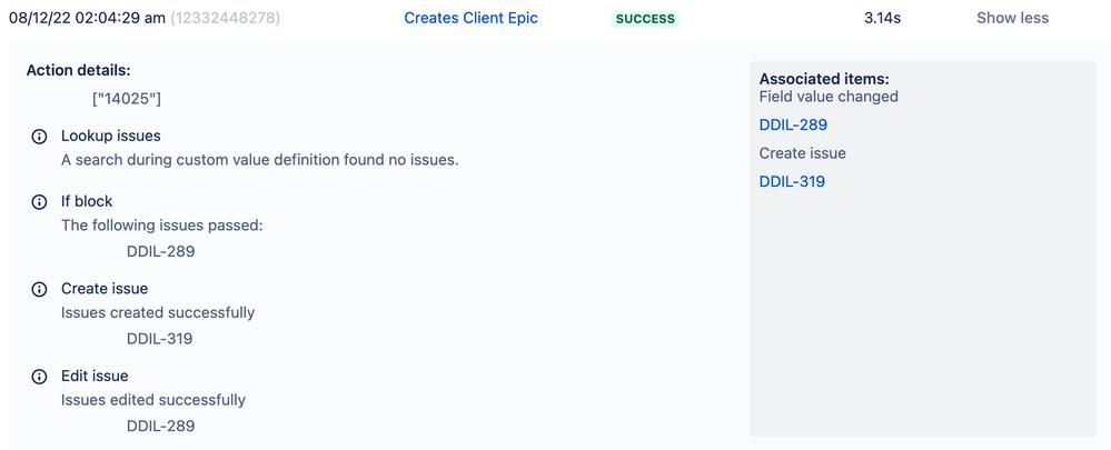

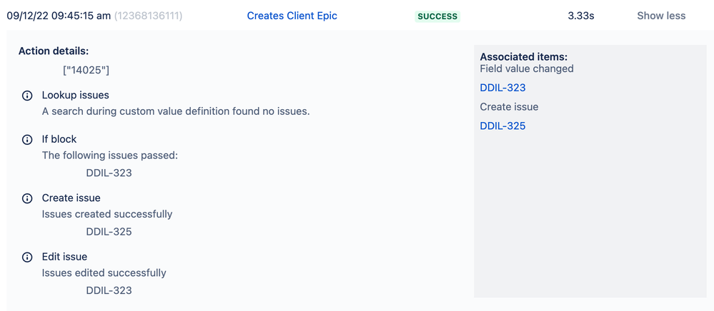

Trudy Claspill
December 9, 2022

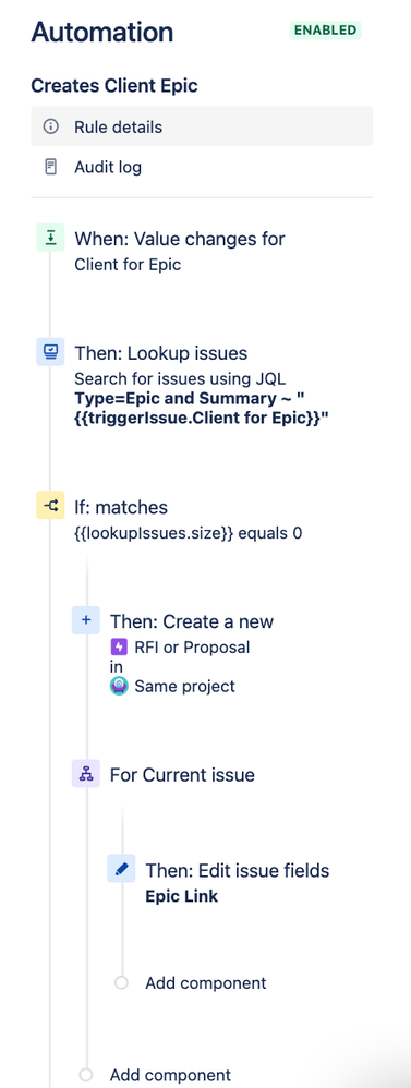

I have created a rule that works with a Team Managed project, with one caveat.
  • If the text in Client for Epic is a single word, and that word appears in the Epic Summary fields either by itself or as part of multiple words, then the Lookup Issues returns multiple issues.
    • Example
      • Epic 1 Summary: Larry
      • Epic 2 Summary: Larry Lewis
      • Client for Epic: Larry
        • Result: Lookup Issues finds 2 matching Epics
      • Client for Epic: Larry L
        • Result: Lookup Issues finds 0 matching Epics
      • Client for Epic: Larry Lewis
        • Result: Lookup Issues finds 1 matching Epic

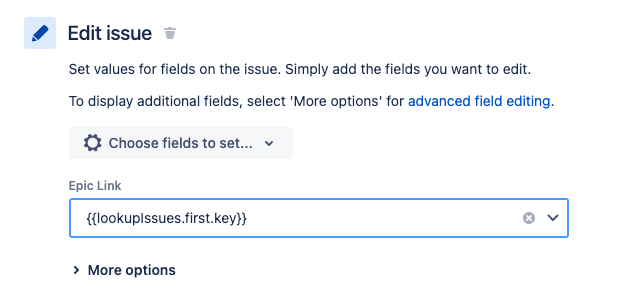

I also discovered that with a Team Managed project now you can set either the Epic Link field or the Parent field for the child issue, and the child issue will be successfully linked to the specified Epic as a child issue. Go figure! I'm nearly positive that Epic Link didn't used to work for linking child issues to Epics in Team Managed projects.
Here's the rule, showing just the Components:
Notes
  • I explicitly add a criteria for my project to the Lookup Issues action.
  • For my final ELSE rather than sending an email I'm just using a Log action to record how many matching Epics were found.
For the Edit action in the IF section these are the details:
For the Edit action in the ELSE-IF section these are the details:
I tested the above rule with the following scenarios, in this order:
 Client for Epic value Epic with matching Summary Exists?  Epic Created?  Trigger issue linked to Epic?
 larry Y
paul N Y Y
larry  Y N Y
larry paul N Y Y
larry p N Y Y
larry Y N N - multiple matching Epics; "larry", "larry paul", "larry p"
Jack Wiltshire
December 7, 2022
Thanks, Unfortunately, it's still creating a 2nd new Epic for the 2nd test ticket. Ill include screenshots for that later on however here is the audit log for the creation of a new epic and then linking the trigger ticket to the new epic as its child. Screenshot 2022-12-08 at 02.07.44.pngScreenshot 2022-12-08 at 02.08.20.png
The earlier time was the 1st test ticket, this did its job as expected.
The other is the 2nd test ticket, which again created a new Epic instead of linking itself to the existing epic.
I think there is an issue with {{lookupIssues.first.key}}.

Thanks, Bill,
See below, maybe you can advise on what's broken here:
The updates to the Epic Links are {{createdIssue.key}} and {{lookupIssues.first.key}} respectively.
Bill Sheboy
December 8, 2022
I notice that your Lookup Issues JQL does not include a project check.  Is it possible there are other issues which have the value in the summary?
Just to confirm, can you post the exact JQL you are using for the lookup...not a screen image?
And if that is not the problem, I wonder if the JQL contains operator is somehow matching/mismatching something else.  You can test that by running the JQL stand-alone in advanced search to see what happens when you expect no second epic to be created:
issueType = Epic AND summary ~ "some example value of your Client for Epic"
Finally, what would you expect this rule to do if the value in Client for Epic is cleared?
Jack Wiltshire
December 8, 2022
Thanks Bill, I did not include a project check as it seems to be adding it itself by the project ID when error I noticed an error code, see the example here.
Please ignore the incorrect formatting of the JQL I was playing around with a few things:
The intended purpose of the automation is as follows:
1. WHEN field "Client for Epic" is populated,
2. IF no Epic already exists where "Summary" = "Client for Epic"
3. THEN Create a new Epic AND link the trigger ticket to the new Epic
4. IF an Epic already exists where "Summary" = "Client for Epic"
5. THEN Link the trigger ticket to the matching Epic.
As requested, my existing JQL for the Lookup is
 Type=Epic and Summary ~ "{{triggerIssue.Client for Epic}}"
 Any help figuring out how I can make the above happen would be great, So far the automation can complete steps 1-3 however when I attempt step 4 it will do the same as step 1-3 which made me believe there was an issue with using
in this situation.
Bill Sheboy
December 8, 2022
The equals = operator is not supported for the Summary field, and so the contains ~ operator is available.
When you test summary ~ "Client for Epic" it will match on any summary which contains at least all of those words.  It could contain other words and the ordering is not guaranteed.
To test for the exact phrasing, please try to escape the search string with quotation marks , with this:
summary ~ "\"Client for Epic\""
or in the rule this would be"
 Type=Epic and Summary ~ "\"{{triggerIssue.Client for Epic}}\""
Jack Wiltshire
December 9, 2022
Yeah as I said I was playing around with something and realised the equals operator wasn't working, I'm not using that anymore don't worry.
Have tried as you suggested however still getting the issue of on the 2nd test issue it will still create a new epic despite the "Client for Epic" matching that of an existing epic.
Please see:
Screenshot 2022-12-09 at 09.45.47.pngScreenshot 2022-12-09 at 09.45.57.pngScreenshot 2022-12-09 at 09.46.15.pngScreenshot 2022-12-09 at 09.46.36.png
Bill Sheboy
December 9, 2022
The summary of the epics you are showing are "TEST" and "TEST 2"...
Is that what you expected?
Your lookup issues JQL is so simple, I am unclear how this cannot work...
When you try this, in advanced issue search and not in a rule, what do you observe?
project = DDIL AND issueType = Epic AND summary ~ "TEST"
And, what is the value of the "Client for Epic" field of the two epics you are showing?
Jack Wiltshire
December 11, 2022
The summary of the issues is "Test" and "Test 2", and the summary of the Epics are both called "Test" and are 2 separate Epics DDIL323 and DDIL324... the value of "Client for Epic" on both issues is "Test" so therefore for the 1st Issue it should have created an Epic, which it did, DDIL323. For the 2nd issue, it should have recognised there was already an epic (DDIL323) and linked itself to this, It did not. It instead created another new Epic... DDIL324.

Jack Wiltshire
December 13, 2022
Thanks to my interal IT guru i managed to resolve the issue.
It was actually something simple, for my project they are no longer called "Epic" but instead "RFI or Proposal", simply changing that in the string got it to work.
Thanks again both for your help.
