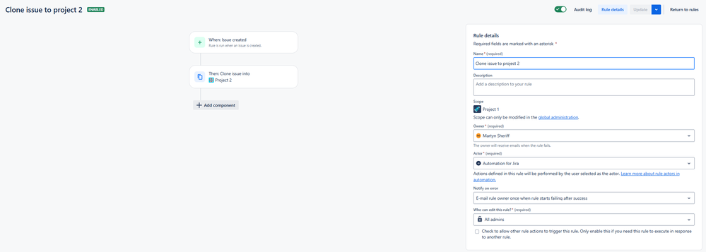

In Project 1 - Created an Automation.
  • When: Issue created (the rule is run when an issue is created).
  • Then: Clone Issue into Project 2.
  • Actor = Automation for JIRA

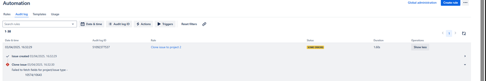

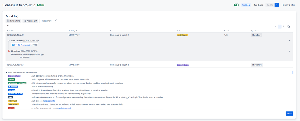

Result when triggered (An Issue is added)
Some Errors entry in the audit log-
Issue created 03/04/2025, 10:23:50
Clone issue 03/04/2025, 10:23:50
Failed to fetch fields for project/issue
type - 10574/10643

In the Clone action for the Issue Type option did you choose Same issue type?
What are the project types of the two projects? To get that information go to the View All Projects page under the Projects menu. Find each project in the list. What is the information in the Type column for each project.
Can you please provide and image showing the complete automation rule?
And can you please provide an image showing all the details in the Audit Log for when the rule ran? Make sure you show all details by clicking all the ">" characters that display along the right edge of the log.

The Issue Type option is set to Same issue type.
Both projects are Team-managed software type projects.

The issue is caused because of your use of Team Managed projects.
With issue types, status values and custom fields, each of those elements has a human readable "name" that you see and a numeric id that you don't see. The numeric id is unique for that element across the Jira instance.
With Team Managed projects the configuration information for the project is project-specific. While you may have identically named issue types, status values, and custom fields in the two projects, each of those has its own unique, project-specific numeric id.
The trigger issue from Project 1 may be named "Story", and you may want to create a "Story" in Project 2, but the "Story" issue type from Project 1 does not exist in Project 2. Those two issue types have different numeric ids in the backend.
When you say that you want to create "Same issue type" in your automation, the backend is trying to find an issue type in the destination project where the issue type numeric id is the same as in the source project. And it can't find that because the numeric id is different for the same-named issue type in the destination project.
You will have to explicitly select the issue type rather than using Same issue type.
You can either create a rule for each issue type, or you can use an IF/ELSE block to check the type of the trigger issue and then use a Clone Issue action that selects the corresponding type in the destination project.
You may run into additional problems copying data between custom fields in these issues if those custom fields are specific to each TM project, and you may run into additional problems trying to transition the linked issues.

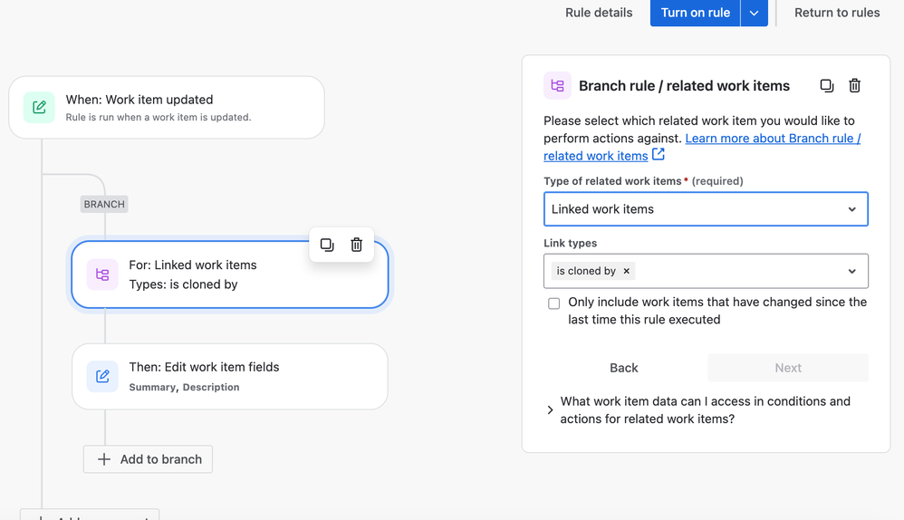

With regard to using Automation to copy every change from the Project 1 work item to the Project 2 work item, that can become a bit complex.

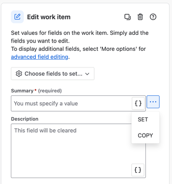

You can use the Work Item Updated trigger to catch most field changes. You would then need to Branch to the linked work item. You would then need to Edit the work item in the branch, copying values from the Trigger work item.
I recommend in your Edit action to select as many of the fields as you can from what is available in the Choose fields to set list. Not all fields will be available there, and there may be some that you don't actually want to copy, like Parent.

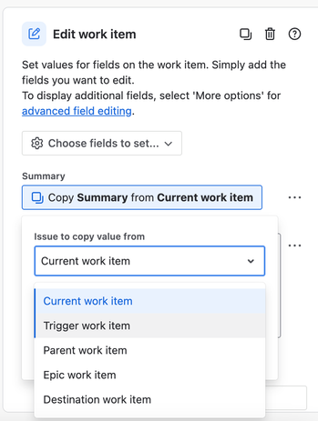

You can then use the COPY option next to each field...
...to copy the data from the same field in the Trigger work item.
For fields that are not available from the list you will have to use the Advanced Editing with JSON feature.
I would recommend separate rules for synchronizing the transitions and comments, using the Work Item Transitioned and Work Item Commented triggers respectfully.
You would use the same branching, but then use the Transition Work Item and Comment Work Item actions, respectively.
