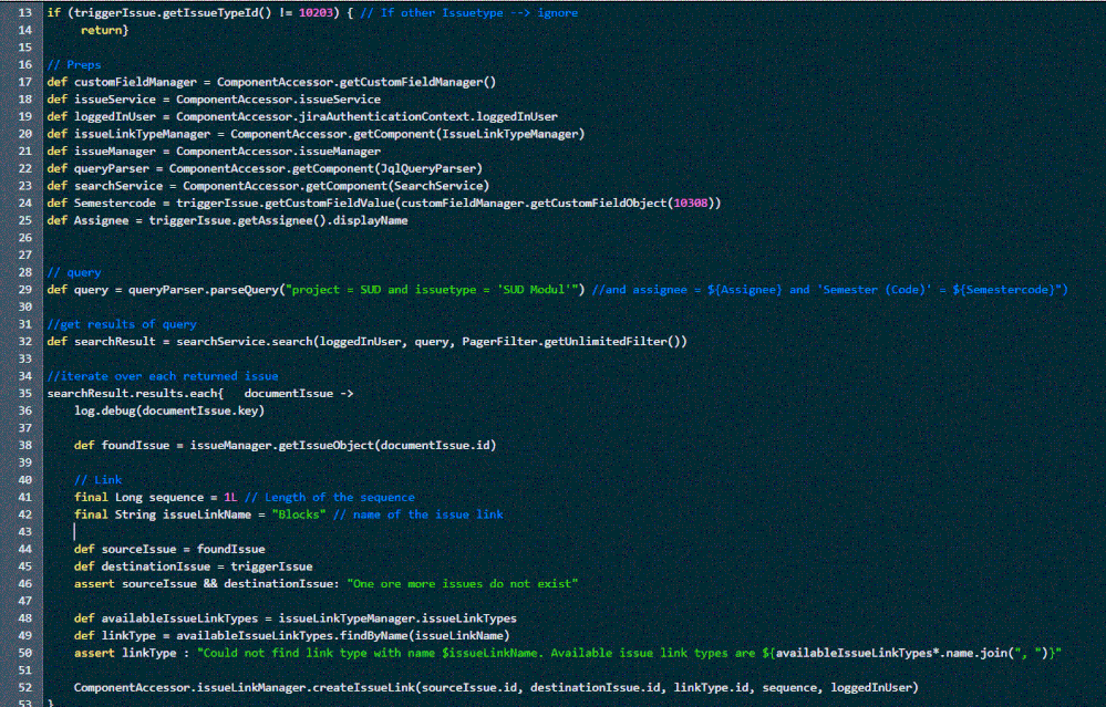

I tried to create a listener that links the issues but it doesnt work. I dont even have an error but when I create a issue (and this creation triggers the listener), the issue has no links.
here is my code:link.GIF
Can you see why it doesnt work? What can I do?

If there are no errors going into the logs (your assert statements should be logging something if there were errors happening within the linking block, if not a crash), then I suspect your code is never getting into the linkage block - my guess would be that the search is not finding any issues to link!

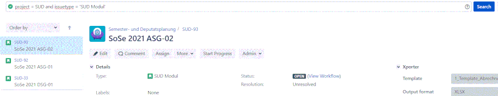

@Nic Brough -Adaptavist- Yes there are no logs. I think you are right, that the code never gets in the linkage block but the query should be alright. I tested it in jira and I found all three issues (see below).
What would you do to find the problem?

I actually found the error, apparently it doesnt work if I write
Issue triggerIssue = event.getIssue()
if (triggerIssue.getIssueTypeId() != 10203) {
return}
 ... when I go just
... then it works, but I dont know why and how I can now make clear that the linking should only apply to specific issues
October 12, 2021
Excellent, that's more than I was going to get!  I was going to talk about logging and following every step in the sequence, but you've got further than that I think.
In your first snippet of code, the "return" will stop the script, ending it with a return code.  So if your first found issue is not of the right type, it won't read any of the others.
What you probably want is something more like
if (triggerIssue.getIssueTypeId() = 10203)
<do all the linking stuff for this issue
This should keep looping over the found issues until you've processed all of them
