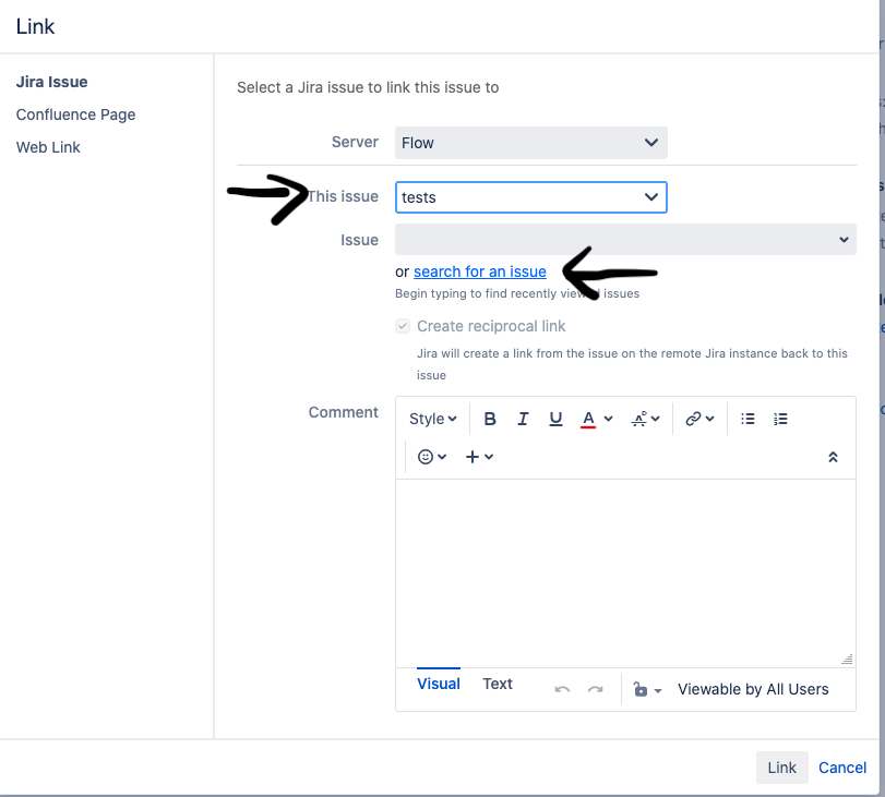

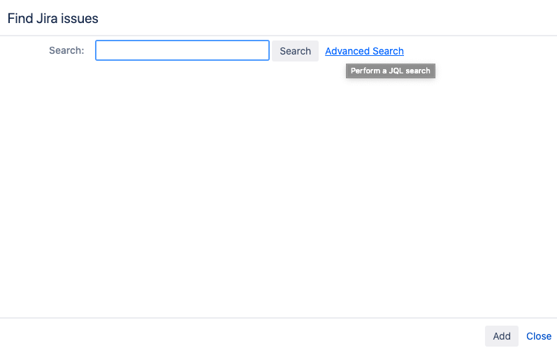

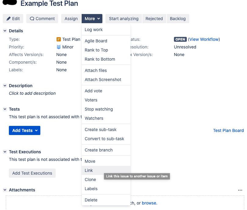

Basically I want to link all the issues (regardless of type) that have the status APPROVE, are in the specific project and the specific fixVersions to the Test Plan.
As these are too many to do manually, I tried to link them by following this path:
Test Plan > More > Link
Then under Jira Issue, I chose tests in the field This issue and clicked on search for an issue. Then I chose advanced search and typed in the query:
project = ProjectName AND fixVersion in (Version 1, Version 2) AND status = Approve
That's where no matter what I searched I got an invalid query message.

I made some screenshots with an example Test Plan. I hope that is clear. The Query would go in the advanced search from the last screenshot. Whatever I type into that advanced search bar is considered invalid.
We want to link issues other than tests or test executions because some stories, bugs or tasks do not have a predefined test. So we want to have easy access to all the issues that need to be tested through the test plan along with all other predefined tests.
