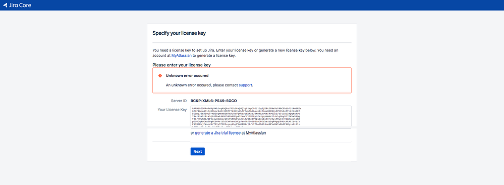

Hi,
I have installed the Jira on our server however the license is not authenticating and the system throws an error in license. can this be checked please?

Hi,
We're getting this

Thank you! I had a look and it appears that Jira is having trouble connecting to your database server for one reason or another, and this could be causing the problem.
Could you confirm your MySQL version as well as which driver you are currently using?
Please also confirm your Jira version.
Are you able to connect directly to the database server from the Jira server?
You may also want to speak to your server admin in order to see why your Jira server might not be able to connect to the MySQL server.
